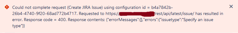

As title suggests I'm trying to create a Jira ticket with ConfiForms and I get this error:

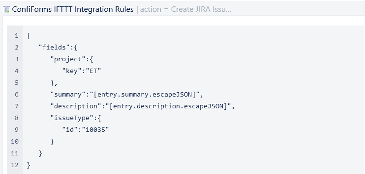

This is my IFTTT configuration:
I have tried using both "id":"xxxxx" and "name":"xxxxx" from a bunch of different issue types listed in (.../rest/api/2/issuetype) but I get the same error. I pasted the above code into a JSON formatter and it passes. Any ideas of what I'm doing wrong?

There is really not much to add, than the error message you get from Jira
10035 is an incorrect id for the issueType field in ET project
BTW, in Jira the issue type is mapped using "issuetype", not "issueType".. as far as I know

Hi Alex, thanks for your response. Same error with "issuetype" unfortunately. Is there a location for all the valid issuetype IDs/names?

Thank you Alex, using the link I was able to find the issuetype IDs used in our project. Marking this as solved
