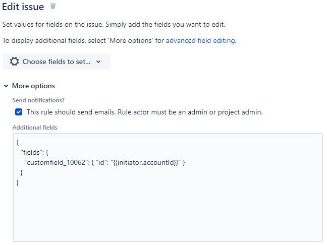

The rule was accepted using customfield (why not field name?), but the rule execution log showed:
   Action details:
   Edit issue
   Error editing issues
   ASTWFR-8 (data was not an array (customfield_10062))
Again, Business Analyst Signoff is a User Picker (single user) field.  Is { "id": "{{initiator.accountId}}" } the name of the user who selected the transition?
Bill Sheboy
May 25, 2022
Would you please post an image of the edit action for your rule, as that may provide some context?  That error does not appear to be related with the user picker, single user field you describe.  Thanks!
Regarding "why not field name", I suspect that the field name you entered in the JSON does not exactly match what the smart value is...which can be confirmed with the instructions I provided.  In some cases, the custom field ID must still be used, such as field names containing special or non-displayable characters.
Regarding your field type, user picker (single user), those are set with automation by either setting the "id" to the user's "accountId" or by setting the field directly, such as with just {{initiator}} (as the default is to use the accountId).  The user's displayName is not used to set user fields.
Phil Bustin
May 25, 2022
The automation worked.  Thank you!
1) Apologies: I had copied the field ID from the next field, not the one I wanted; I hadn't realized that the colon and comma meant the ID came first, then the field name.  The automation you see below worked with that correction.
2) If by "smart value", if you mean the field name that appears after the ID, the name sure looks the same as the one I first tried in the rule, but when I coped it from the report (can I call it a report?) and pasted it into the JSON, it worked.  I'll try to figure that one out.
