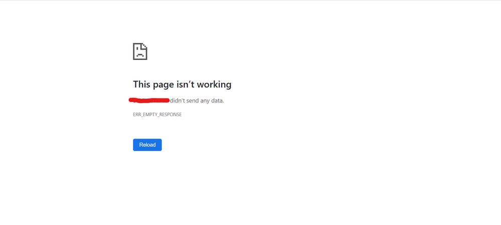

I have been following this guide: https://confluence.atlassian.com/adminjiraserver/installing-jira-applications-on-linux-938846841.html
and no matter what I try, no matter where I look, absolutely nothing appears on localhost:8080. I'm trying to install Jira on an AWS EC2 (I've tried t2.micro, t3.small, t3.medium), but all I get is the attached image. Annotation 2020-03-16 121725.pngCan someone please help?

I found out what happened. I was using AWS and the security group was only configured to only traffic into port 22. When I opened the other ports, I was able to see Jira in the web browser.

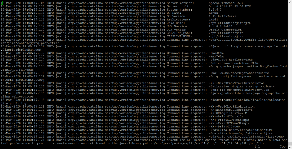

I should mention I'm new to Linux; how would I check that the process is running?
The attached image is what I see when I check the logs:

It is, indeed, a bit hard to say without having a deeper look into log files.
An important log file is atlassian-jira.log - you can find it in your JIRA_HOME/log directory.
To check if the process is running you could use the top, htop or ps command.
It is hard to say if there is something critical missing for your installation without a deeper look into the system.
I'd recommend also to check with the netstat command (netstat -tuan should be a proper start) to see if the port 8080 is really not opened - or if there is just a firewall rule blocking access.
