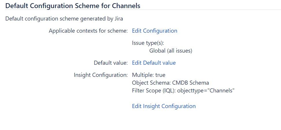

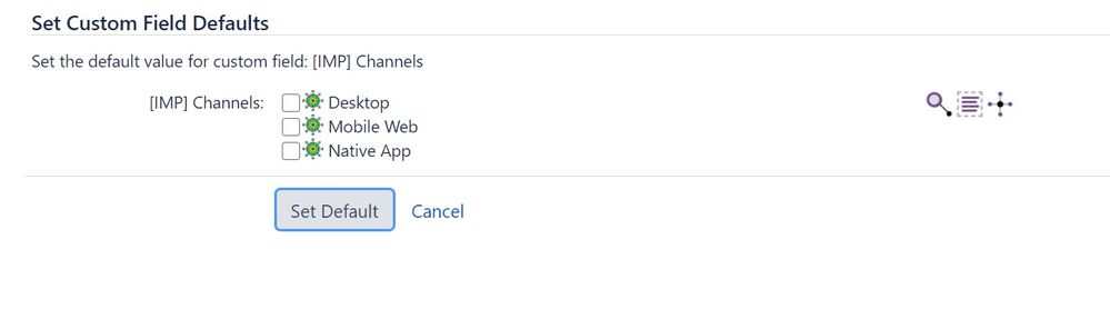

Hi @Hana Kučerová ,
I noticed that yesterday.
On this field, context was global and for all project. However, we didn't set default value.
defaultvalueinsightfields.jpgIt's look like linked to the global configuration.
Can you confirm it?

Hi @Mickaël ORSOLINO ,
thank you. The field is global, but the default value is not set, so the custom field is probably not set during creation.
I recommend you to limit the context of the custom field, but still we need to find out, why there are so many connections.

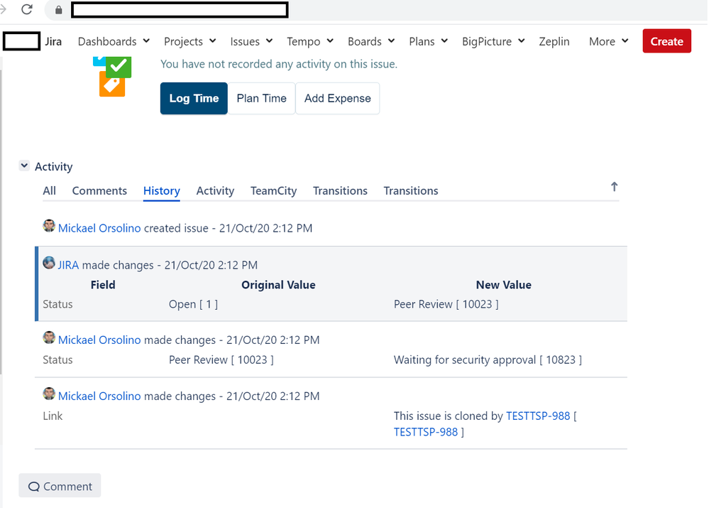

Mickaël ORSOLINO
November 17, 2020
HI @Hana Kučerová ,
It's very weird because I don't see anything on the history/Activty tab on each ticket.
Its an example of impacted ticket on a test project:
For the concerned field, I have only two screen associated:
On this case, the field is still global. I think it's only linked to the context.

Hana Kučerová
November 18, 2020
Thank you. Hmmm... this really indicates, that these issues are created with this value.
Please, just to be sure - check the usage of the two screens, which are associated with your custom field.
  • Look into project's settings ->Screens
  • Are the "Issue Type Screen Scheme" and "Screen schemes" and "Screens" really not shared with the other projects?
Then please, try to also look to the used workflow(s) in your other projects - are there any (Insight) post functions on the first (create) transition?
You can also check the Audit log (Administration -> System -> Audit log) and try to search for config changes on your custom field (maybe there's been some default value in the past?).
