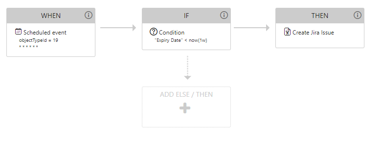

Hi,
I am trying to write a simple automation rule in Insight, to notify someone (via a Jira Issue), when a 'Date'-attribute is within the next week (iql: "Expiry Date" < now(1w)).

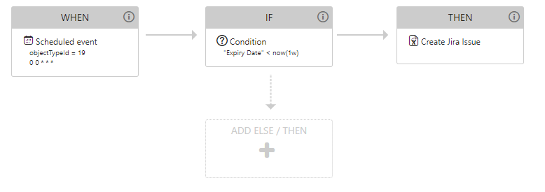

When I use 'Scheduled event' with the configuration 'objectTypeId = 19' and one of the following cron expressions, no ticket is getting created.
cron expressions:
  • 0 0 * * *

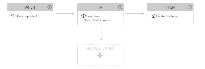

However, when I use 'Object updated', leave the rest the same and manually change a 'text'-attribute it works.
I also tested the iql 'objectTypeId = 19 and "Expiry Date" < now(1w)' via the rest-API and got a correct result.
Maybe someone has an idea what I am doing wrong?
Thanks in advance,
Philipp
Screenshots of my tests:
cron_at_0000.pngcron_every_minute.pngcron_every_second.pngThis one works:on_update.png

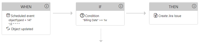

Fabian Wimberger
October 30, 2020
Dear @Marco Brundel
I just tried to verify the same but it really seems like the cron expressions do not work in our cloud deployment. We tried several expressions out of the documentation:
* * * * * - did not work
*/2 * * * * - did not work
0 0 * * * - did not work
However, changing the trigger to "Object updated" + changing the object, immediately results in the desired task to be created inside one of our KANBAN boards.
In short:
works.
image.pngdoes not work.
We would appreciate your help.
Best regards,
Fabian Wimberger
Add.: The created task names were changed inbetween tests to not result in overwritten/ignored tasks.

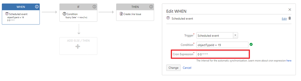

Marco Brundel
September 28, 2020
Hi @Philipp Eichinger ,
I think objectid belongs in the condition and not in the "when".
See also https://documentation.mindville.com/display/ICV84/Insight+Automation#InsightAutomation-Scheduledevents
"when and how often the provided Condition will try to match Insight objects"
Regards, Marco

Marco Brundel
October 4, 2020
Hi,
I think you should indicate in the "when" how often you want the rule to be executed. For example once a day.
In the "IF" you then note which items must be checked daily.
Regards, Marco
Philipp Eichinger
October 7, 2020
Hi,
The other of my tests are exactly the same (apart from different cron-expressions).
Regards, Philipp
