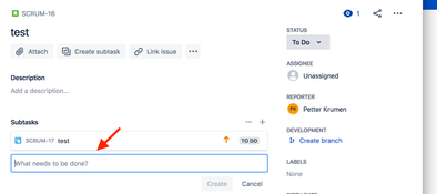

Whenever we try to create a sub-task using inline field in the Story, it brings up a full dialog.
There are no additional required fields that need to be filled when the full dialog comes up.

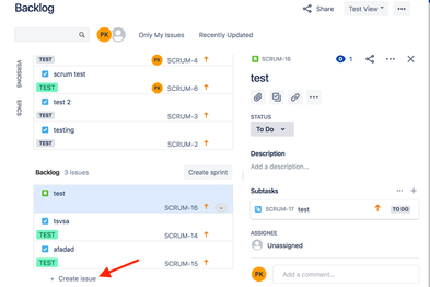

The following link states that your board's filter must only include one project, and ours does:
https://confluence.atlassian.com/jirasoftwarecloud/creating-issues-and-sub-tasks-764478439.html

Hello Sergey,
Just to make sure we are on the same page:
When you say the option to create sub-task using the "inline" field, you are talking about the inline option of any Story (As displayed in the first screenshot) or in the inline option of the board (The one that is mentioned in the documentation you provided and displayed in the second screenshot below)?
Screen Shot 2019-10-28 at 16.34.09.pngScreen Shot 2019-10-28 at 16.34.17.png

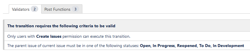

3 - Double-check if there are any validators in the create transition of the workflow that might be setting any field as required

To answer your question, it is in the Story, not the board.
1. I confirmed that there are only two required fields: Type and Summary. All other fields are optional and not set during the full-window creation of the subtask. Flagging all of the fields does not solve the issue.

3. No required fields on validators:
