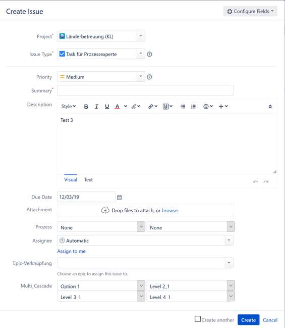

This is the create-screen:
2019-03-12 07_19_53-Create Issue - Jira.pngNow, I want the field assignee to change according to the value of the field Multi_Cascade and I want to see the changes in this screen, before I click Create. I tried with a behavior and the Initializer, this does only work if the field Multi_Cascade is set prior to opening the create screen, but does not update the assignee for further changes on the field Multi_Cascade. Maybe a behavior is the right tool for this and I am missing something.

Yes, it is from another vendor. They have some examples in the documentatiom regarding scriptrunner, and it seems to work a little different than a standard field. The multi-cascade does not return the selected value but it returns a code for the selected entry, for example, the selection in the screenshot does not return "Option 1 - Level 2_1 - Level 3_1 - Level 4_1" but the code "10101 - 10102 - 10103 -10104". This means I have to implement some sort of mapping here.
The funny part is that the multi-cascade returns the string "Option 1 - Level 2_1 - Level 3_1 - Level 4_1" when accessed via the ComponentAccessor.getCustomFieldManager().
I guess I´ll have to work with the codes for now. Thank you for your time.
