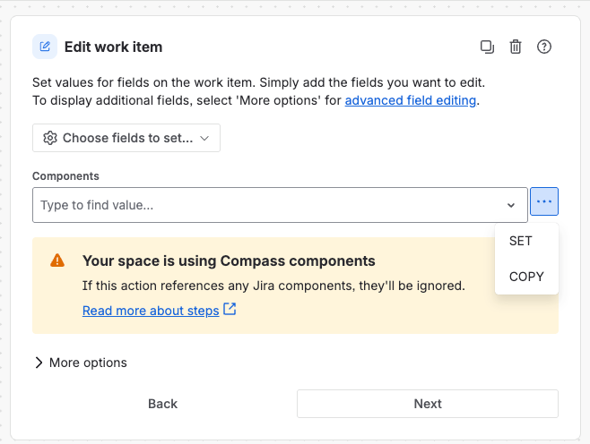

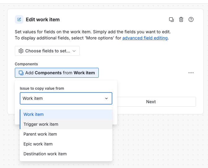

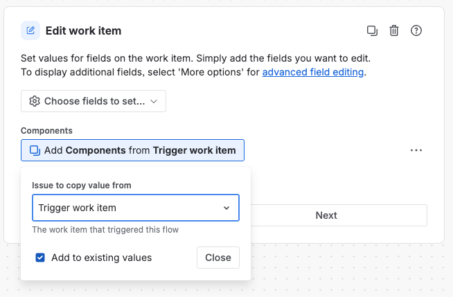

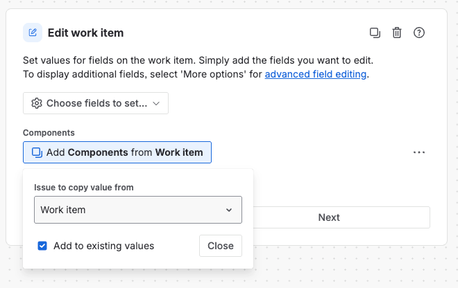

For many fields it is not necessary to use smart values to copy from the trigger issue. Consider the flow of selections shown below:
Screenshot 2026-05-22 at 9.03.09 AM.pngScreenshot 2026-05-22 at 9.03.18 AM.pngScreenshot 2026-05-22 at 9.03.27 AM.pngScreenshot 2026-05-22 at 9.03.37 AM.png

Good clarification: for supported fields, using the “Copy from trigger issue” option in the Edit issue action is cleaner than typing smart values manually.
I would still use smart values when the field is not available in the picker, or when the value needs to be transformed before being copied.
