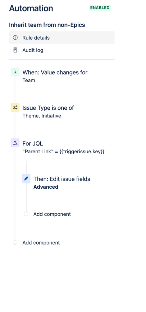

The non epics rule was intended to populate the team field in initiatives and epics from Themes and initiatives respectively. It looks like this:
The action was the following JQL:
"fields": {
"team": "{{triggerissue.team.id}}"

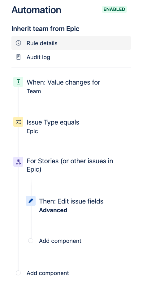

The other automation rule was to cover stories/bugs/tasks having their team field copied from the Epic they are in. This rule looked like this :
and the action part was JQL that looked like this:
"fields": {
"team": "{{issue.epic.team.id}}"
Both of these worked independently, but I need to couple them together so that if a Theme was changed, it rippled down through initiative, epic and story. In order to do this, I checked the checkbox in the rule details for BOTH rules as follows:

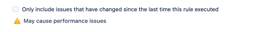

This still didn't quite work until I also changed a setting in the Epic rule branch definition to uncheck the following box:
Unchecking this box gives you a warning about performance issues as can be seen above, but I haven't noticed any perceptible change.
