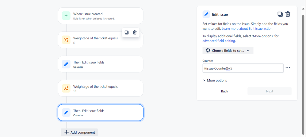

So, if you see the above example which I tried. I have "Weightage of the ticket" as a select list (single choice) field and Counter (Single line Text field). So, when the issue is been created, if the weightage is chosen and the counter field will get updated by 4 for 5 weightage and 5 for 10 weightages.
Hope this helps!

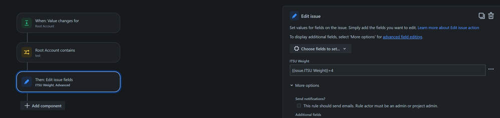

I tried something similar but still doesn't work

Smart values cannot be directly added, except for setting number fields.
Otherwise that will produce a text value.  For example, {{issue.ITSU Weight}}+4 will instead concatenate the values, such as 10+4 and not 14.
Please review the documentation for how to add values, either with the inline or longer form math expressions:
https://support.atlassian.com/cloud-automation/docs/jira-smart-values-math-expressions/
One additional possible cause of the error is the smart value may be incorrect for the field.  Specifically that "ITSU Weight" may be null.
Smart values are name, spacing, and case-sensitive.  And often the smart value does not match the displayed field name on the issue views.  These steps help to identify the correct smart value (and custom field id) for the fields.
