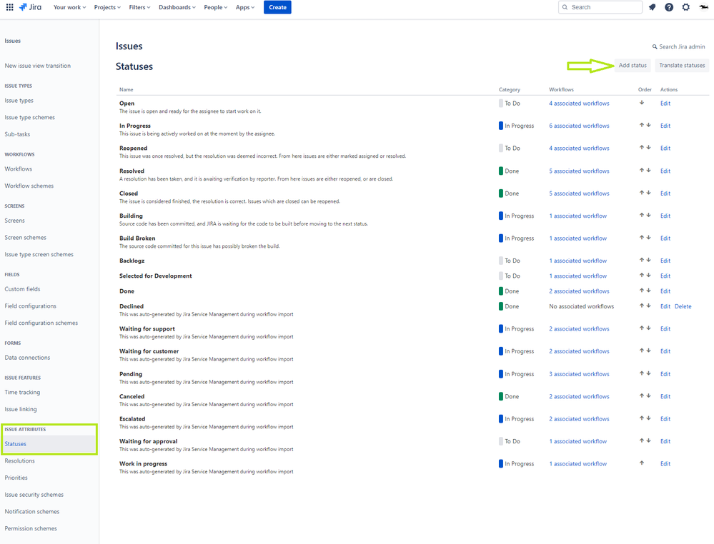

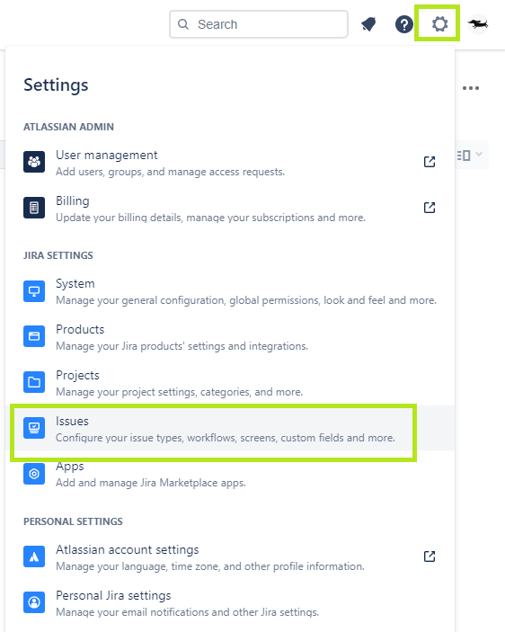

You should be able to see the gear in the top right corner and click "Issues"
This will take you to the Admin section where you can play with alllll the good stuff, including making new Statuses that can be used in the whole Jira instance.
Once you are there look waaaaay down on the left hand side
You will see the "ISSUE ATTRIBUTES" section and under it "Statuses"
Then you will see the list of all of your global statuses
and on the top right side "Add Status"
CJ Edwards
May 6, 2022
This is what you should see after clickingimage.png the Issues Link above

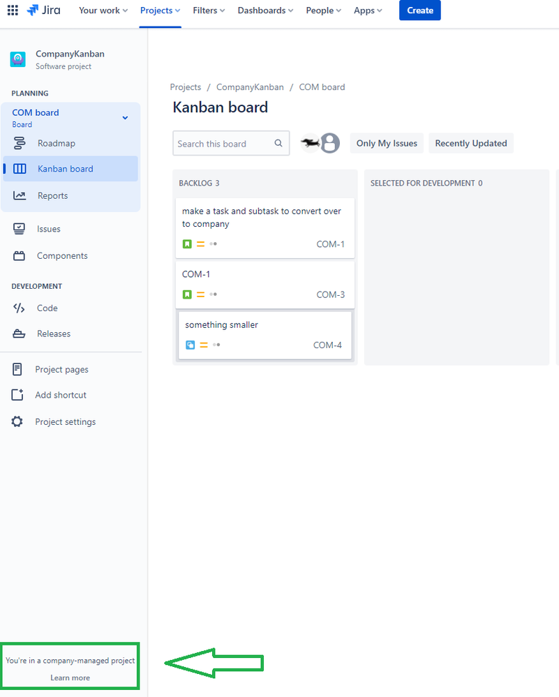

I don't know how to identify the kind of project, not how to define it when I create it.  I don't mind working within a Team Managed project and creating a status there, if I can add it to the workflow.
CJ Edwards
May 6, 2022
Easy peazy!
Phil Bustin
May 6, 2022
Thanks.  I see the project type at the bottom of the navigation panel.  After some close examination of screens, I succeeded in creating a project, selecting Company Managed, creating a Task, and editing its workflow; the Edit function allowed me to add a Subtask.  Assuming I can navigate those waters again, I guess I'm all set.

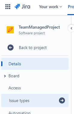

In Team Managed Projects you will want to add fields to your issues by going to Project Settings, Issue Types
From there you can do as you need!

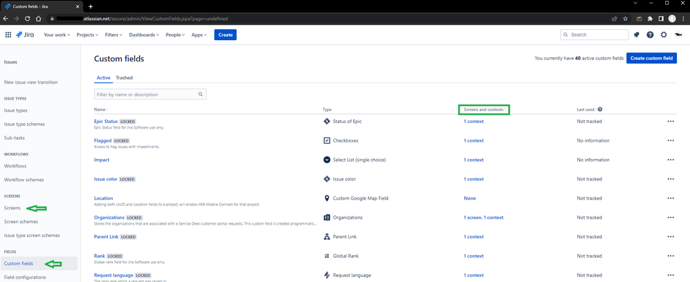

When you create fields to be active in a Company project you need to designate the "Screens" where they can be seen, uses Schemes, in conjunction with "Fields"
"Context" of the custom field determines what combination of projects, screens and Issue Types will be used
All must be used correctly to see and use the Field in a project/issue

I tried to find a place to add screens to my field.  Can it only be done upon creation (I doubt it).  I'll keep looking, and will try to find the view for which you provided a screen shot.
CJ Edwards
May 6, 2022
I left the address in the Bar for reference for you as well :)
xyz.atlassian.net/jira/settings/issues/screens
Cheers!
