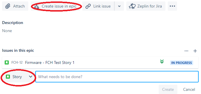

When open epic in issue view, and try to create issues with in epic, then "Project" field doesn't appear. Steps are:
1. Open epic in new tab
2. Click on "Create issue in epic" button
3. Under "Issues in this epic", issuetype dropdown appears, and product owner can add summary. but, product owner can't select project name.How_to_show_project_field.png

Hi Ashish,
This appears to be some lost functionality in the New Jira Issue View. If you use the Old view you will see the process as you describe in the top part of your question where you can change the project.
But in the New Jira Issue View, the functionality is different. You can go to the Feature Request here to see if there is a sub-task that captures this need already. Or you can submit a new Feature Request.

Hi @Ashish Pandey
Whilst you're correct, there is a variation when using the add options within an Epic's main issue view.
However, the original process you mentioned - creating child issues from the Epic Panel on a board - works the same in the old or new issue view. If this is an option for your product owners, I would advise asking them to do it via here to make it easier :)
