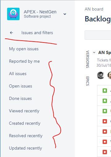

In backlog view I click Issues & Filters - how do I get it to show my favourites & not other
Lana Ellis
August 22, 2018
When I am in my project and am looking at the backlog view I click Issues & Filters.  I only see 'other' filters and I can't figure out how to see my favourites from here.
If this is not possible what is the simplest way to view your favourite filters?

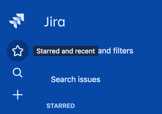

When you click on this, you are actually clicking on the filters for that project. You can achieve what you are looking for in a couple of ways.
1) Click on the star icon in the upper right-hand corner. This will allow you to see several different options including favorite filters.
2) Type "/" and it will open up a search bar. On the bottom there is a small link that says filters. You can click on that link and search for your favorite filters. There is even a section that says "Starred" and contains your favorite filters.
Hope this helps!
