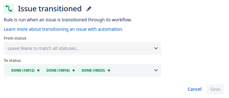

I'm working on an automation workflow.
I am using a project setup I would think is very common, where I have multiple projects with the same column name "Done" on each of their boards.
When creating an automation rule, the statuses are presented without any way of knowing which corresponds to which project.
Example:
I think it shouldn't be hard to simply display the project name in parenthesis instead of these mystery numbers.
At the very least, there should exist documentation as to what those numbers are or how to search for them to see which status relates to which project. I cannot find any way to search for those numbers, nor any label or use for them at all.
Thanks for your help,
Luke

It appears that you are dealing with a TMP project or at least the image you presented above illustrates this. One issue with TMP projects is that the statuses are self contained within the project. What that means is Done in TMP project 1 is not the same as Done in TMP project 2. This explains the 10012, 10016, 10023.

We have TMP and CMP projects in our environment, many with the Done status. Our TMP projects say that the Done status is shared across multiple workflows, and the Delete button is disabled for deleting that status in our TMP projects. When I try to construct an automation rule, whether at the Project or Global level, I'm only seeing one Done value show up in the picklist. I can't recreate what Luke is seeing.

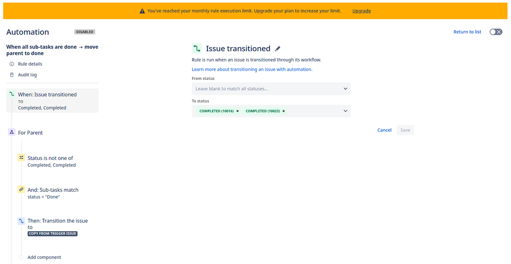

Hi @Jack Brickey , @Bill Sheboy , and @Trudy P Claspill , thank you very much for your help and experimentation! As I replied to Trudy, this was with 3 TMPs created from the Scrum template.
When creating a new Global rule and using the "Issue transitioned" trigger option, it does not appear that there's an option to select which project(s) it applies to. This is fine for this particular rule. I wasn't the one that set up this rule, but as my team is decently new to Jira I thought that it was a default rule created by Jira.
Here's another screenshot, taken after one of our projects was deleted and I renamed the remaining two projects' "Done" columns to "Completed". I can assure y'all that I am not adding the parenthesis and numbers myself. The numbers remained the same, showing that they're essentially the actual "ID" of the object relating to the status column.
Imo it is helpful that the statuses would not appear identically so that one could create global rules and apply that kind of project filtering through the settings of the trigger used. However, the current labels aren't any more helpful than if they were separate without the labels or a single option matching all instances of that status across projects.
