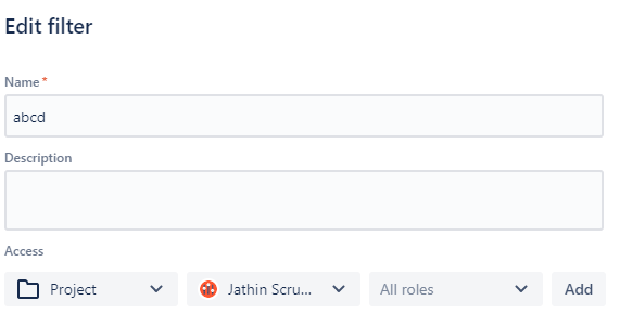

Create a board for backlog view for all
Board 1 -------- Board JQL --> Project = ABC and Sprint is EMPTY. --> Filter permissions ( All project users)
Board 2 -------- Board JQL --> Project = ABC  --> Filter permissions ( Project specified roles / groups)

However, you could create additional boards that use a filter with the Next-gen project. Then you could restrict the sharing of the filter, which restricts the sharing of the board.

Sure, create a new filter for the project. It can be as simple as Project = ABC where ABC is the Next-gen project code. Be sure to save it and share it.
Then navigate to your list of all boards and click on the Create board link.
Select Scrum or Kanban and base it on an existing filter. Then use the filter you just created.
For the Location, you will not be able to link it to the actual Next-gen project, but that is okay, it will still work. Just link it to your profile.
Then you should be able to make your adjustments.

@Daniel Schultz Nielsen you may find providing stakeholders outside your team with a saved filter may also satisfy your needs. It is similar to the above (but above you would need to go one step further and create the board using the filter - which would allow you to show the issues on a Backlog view).
The support doc for filters is here... https://support.atlassian.com/jira-software-cloud/docs/save-your-search-as-a-filter
The JQL you need would be something like this... project = <project name> and (Sprint is empty or Sprint in futureSprints())
