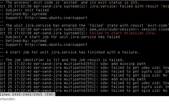

Hello ,
i installed Ubuntu 20 with Jira 8.13 . In Installation you are get asked. You want "Autostart"
. But this is not working.
Also not with this script -> Start Jira applications automatically in Linux | Jira | Atlassian Documentation
There also an other Dokumentation . And not with this Run Jira as a systemd service on linux | Jira | Atlassian Documentation
Greets
Ralf
Nic Brough -Adaptavist-
October 25, 2021
What is the error message the start up is reporting?   What do systemctl status and journalctl -xe report immediately after you run the start?
That multipathd error you are getting could also be the root cause, it's telling you that your disks are not configured right or possibly not available (usually happens when a VM has not been set up correctly)
