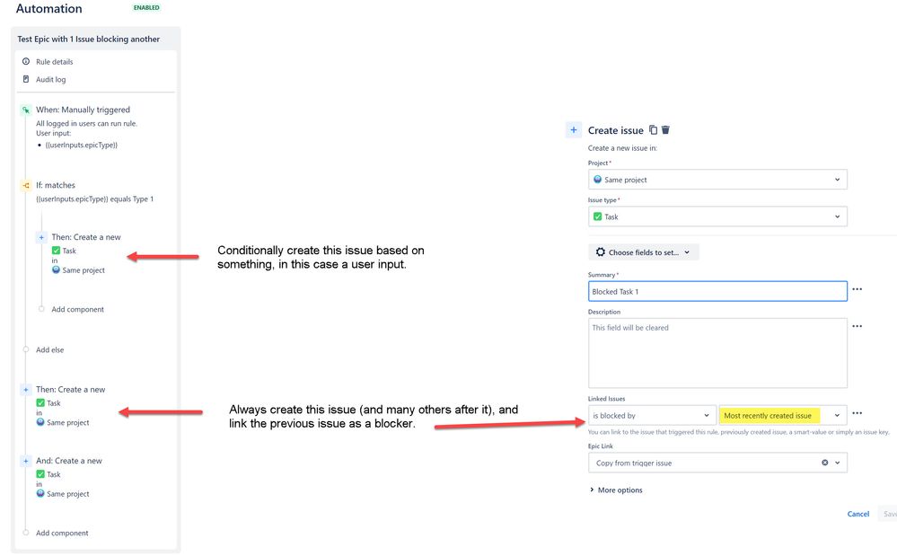

Here's a simplified version of what I am trying to do.
  • Create several issues in sequence, where each issue created is blocked by the previous one.
  • Some of the issues are conditional, based on "some value", like a user input when the rule is triggered (or alternatively maybe some field in the triggering issue).
  • Because a conditional issue is created in a branch (IF/Else block), the subsequent issue cannot be blocked by it using "Most recent created issue".
I am using an IF/Else because I need the rule to continue processing even after a false. If I used an "Issue field condition" to create the issue in the main thread, it would just stop on a false and not create all the non conditional issues that come afterwards.
I am trying to avoid duplicating the creation of the SAME issue in several branches. There are a lot of issues being created in my rule (about 20).
I just thought of a way, but it's not great: Instead of conditionally CREATING the issues, I could ALWAYS create them, and then conditionally DELETE the Most recent issue created if it shouldn't have been created.  <_ edit: won't work because the deleted issue will be the "Most recently created issue" and that will mess up my links downstream.
I'm sure there is a better way...

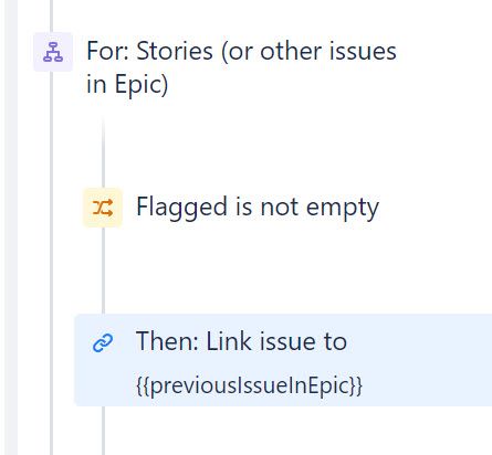

Since all the issues are created in an Epic, I would have access to that list of issues at the end of the rule. When I create the issues in a branch, I could flag them, then at the end of the rule, loop over all the issues in the Epic, and for the ones that are flagged, link to the previous issue in the epic. But I don't know how to reference the index of the previous issue in that loop.

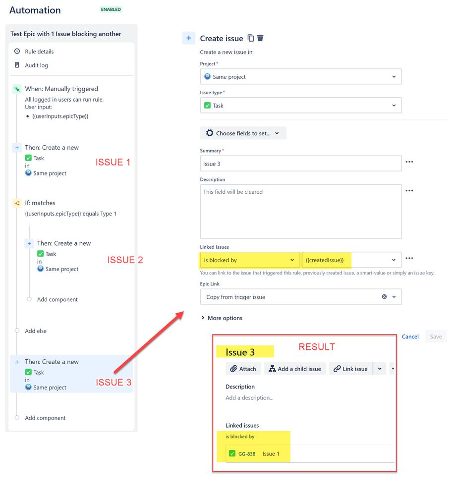

Hmmm... I am not seeing that {{createdIssue.key}} of the issue created within the if/else block (or "Most recently created issue") is available to the issue created outside the block subsequently. The second issue never has the "blocked by" link to the issue created in the if/esle block. If/else appears to be behaving like a branch.
In the case where the first issue is not created, I expect the link will simply not be created, or it will be created with an issue that was created above it.
I won't reach the 65 component limit, thankfully, but good to know that limit exists. My rule has 42 components right now, and I am done, other than this annoying linking issue.
I am curious to hear how you are getting the {{createdIssue}} to be accessible outside the if/else block! That's specifically what I need, but I cannot get it to work.
I modified the rule to test this out. The result of this automation is 3 issues created as expected, but Issue 3 is blocked by Issue 1, not issue 2.

I reproduced that symptom, and you have found a defect:
For a Create Issue action inside of an if/else clause, when using issue linking both the Most Recently Created Issue (drop-down value) and {{createdIssue}} smart value incorrectly identify the last created issue as any issue created *before* the if/else clause.
Now here is a work-around that may help solve this using created variables.  You should only need this for the if/else cases.
  • trigger: manual, with user input
  • action: create issue
  • action: create variable, saving {{createdIssue.key}} as varLastCreatedKey
  • if/else condition
    • condition: for your input test
    • action: create issue, linking to {{varLastCreatedKey}} instead of from the drop-down
    • action: create variable again, saving {{createdIssue.key}} as varLastCreatedKey
This works because the second call to Create Variable using the same variable name replaces it, and so can be used outside of the if/else clause.
