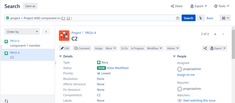

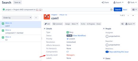

Sachin
July 20, 2020
Hello @CA , can you confirm if there is any issue security scheme associated with your project? You can look at the issue security scheme from your project settings.
You won't be able to see the issues with security level in your results if there is a issue security level configured on your project and you are not granted security level permissions. See screenshots below.
