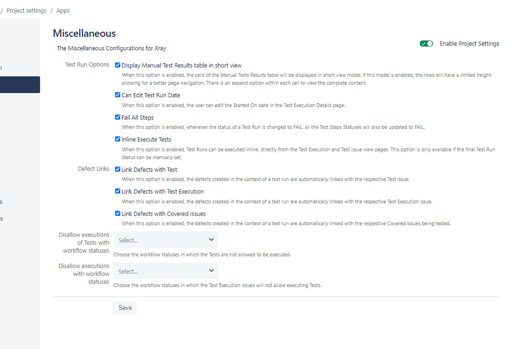

Under the Miscellaneous section in the XRay settings there's an option to specify User Groups Allowed to Add XRay Issue Types. Is it possible you are in a User Group that is not allowed to add XRay issue types?

Thank you for your Answer.
This is the configuration I have:
 cap3.PNGI add it was me who has configured all the issue types (Test, Test Execution,... )of the project.
