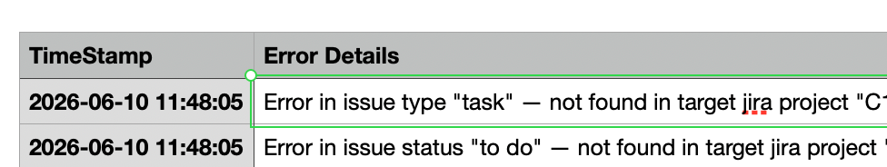

And yet when i import:
Error in issue type "task" — not found in target jira project "<jira project>",Issue type task is missing in your Jira project.
Error in issue status "to do" — not found in target jira project "<jira project>",
Issue status to do is missing in your Jira project
Which is accurate since the project does not have that worktype and status. But why is it trying to map to them anyway since i have explicitly mapped to the correct (and existent) type and status

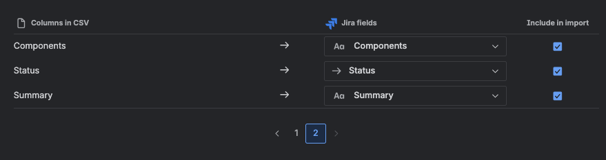

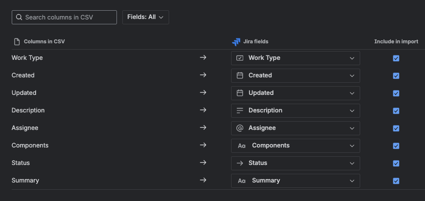

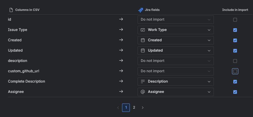

Marc -Devoteam-
June 10, 2026
Hi @Samit
Can you provide your mapping on the import and the error log
Also what are the steps you are taking?
Samit
June 10, 2026
Samit
June 10, 2026
Thanks @Marc -Devoteam-  - As screenshots above, nothing too complex

Samit
June 10, 2026
HI @Marc -Devoteam-  No there were no extra rows, But to be sure I created a brand new csv (same data) as well as removed any surplus columns that would not be mapped Plus made the csv headers like for like with the jira mapping fields
So every column has a corresponding Jira  field.
image.pngAnd same error
