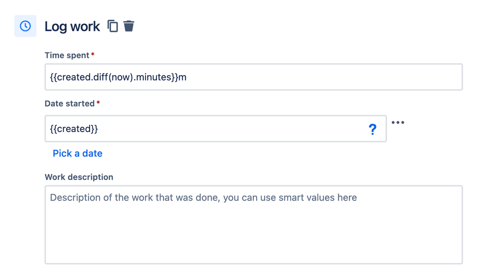

I have used the below automation to automatically log work for issues

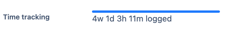

and with this the work logging is automated

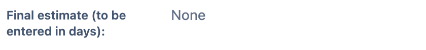

but is there a way to get this work log data updated in a custom field created for that particular project? (Custom field reference below)
Gokaraju gopi
July 16, 2023
@Mithila N BhatWhat is the type of the custom field(Final estimate) ?
Mithila N Bhat
July 16, 2023
Hi @Gokaraju gopi its a text field

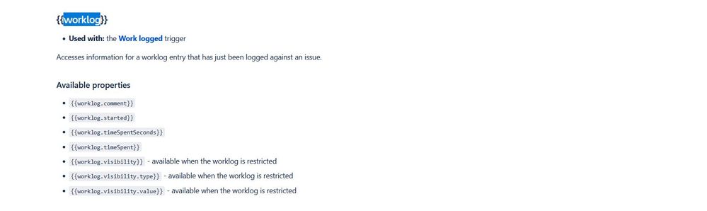

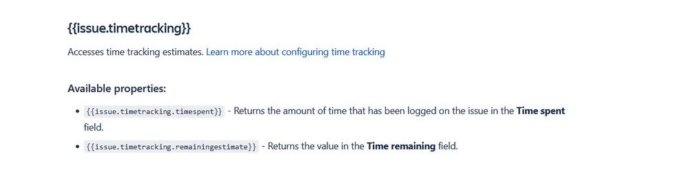

@Mithila N BhatYou can use following two smart values to get work log data and update the custom field when your automation rule is triggered
Check following documentation for smart values
https://support.atlassian.com/cloud-automation/docs/jira-smart-values-issues/
