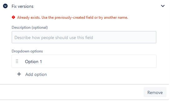

When I add a drop down context field in the new project, it has attributes and if I use the same name (Fix versions) I get an error message !?!
This is the simplest of actions and already an error. It is kind of intimidating. Can you help?

I have added a drop down context field "Fix version" to the task issue type (which was the default issue type after creating the project). The error comes up when I give the drop down context field in the the ne bug issue type.
In the older project, the "fix versions" field is in the task, finding and bug issue types, so I assumed that the context fields belong to the issue type and are local. Is this no longer possible?

Hello @Jack Brickey ,
issue resolved. User error :-(
It seems that the error message is due to my taking the pull down from the "Create a Field" section and trying to give the new pulldown a name that already exists in the "Previously-created fields" section. When I take the the pulldown from the "Previously-created fields" section, then everything works as expected. Sorry for the beginners mistake.
