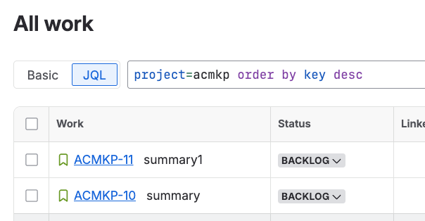

For example, the highest number used in my project ACMKP  is 11.

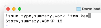

I can use a simple file like this to create a new work item in the project with a higher number - 15

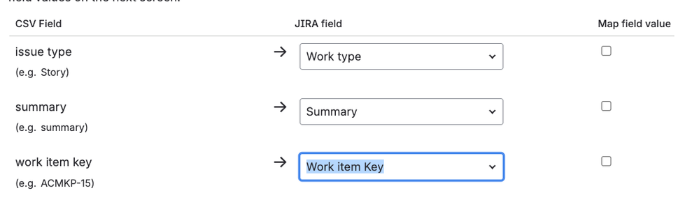

This is the mapping I use.

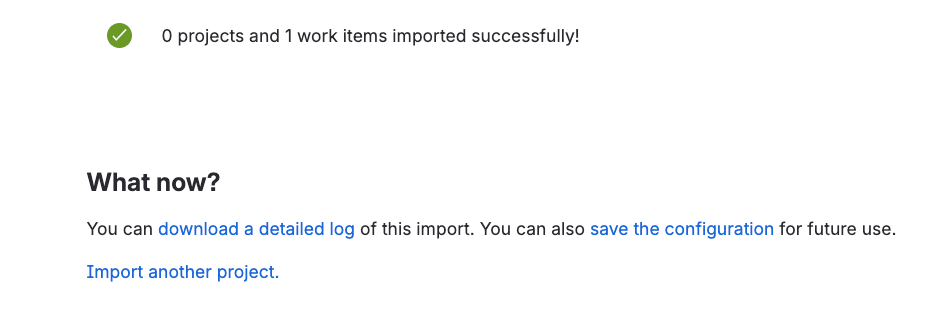

And this is the result that it reports.

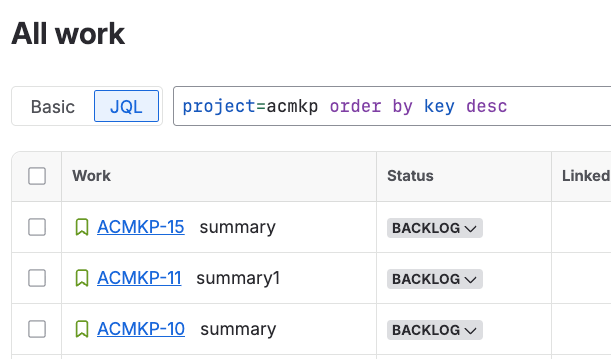

The autonumbering of issues would assign "16" to the next issue created.
I have only used this method to do a single bump of the number. I have not used this method to create multiple issues with specific keys but theoretically that would be possible if the import is executed by a Jira Admin.
In the CSV file I would make sure that the items are listed in issue key order, ascending. Also make sure that the first number used is not within the range of numbers already used in the file.
If you need to import parent and child issues in the same file this could be problematic. Parent issues all need to be listed in the file before their child issues. If that doesn't align with the ascending order of the issue numbers, then you may not be able to accomplish your desired goal.

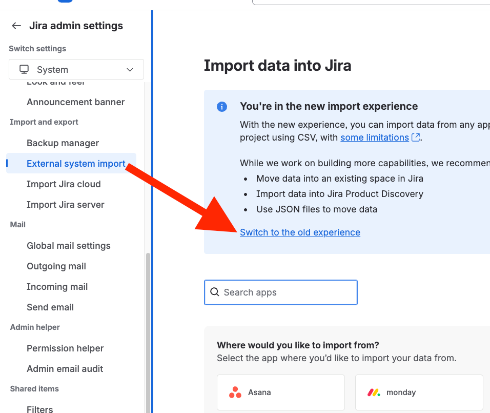

To get the work item key option you need to go through the External System Import option.
Click the gear icon near your avatar and select System.
Find and click on the External System Import option. You should see a screen like this.
Click the Switch to the old experience option, and proceed with your import.

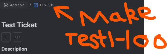

My goal is to change the number of a work item key. This is because my original ticketing system didn't start off in Jira. I was using another ticketing system.
I'm starting off with test tickets, but I eventually want to learn how to set an incident ticket to a specific number. I attached an example of what I'm looking for.
From my understanding, I'm supposed to upload a CSV file to change the value. I've tried this a few times and couldn't figure out how to make this work. Any assistance is appreciated.
