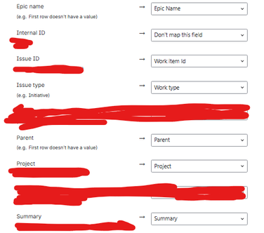

Using the following configuration:
However, I get the following error:

Please show a screenshot of your mapping.

Thanks for your input. I am not using the Epic Link field as you can see in my configuration screenshot.
For me, your mapping looks correct for Parent, but the values in your CSV for Parent must match the expected format (the Epic’s issue key, not an ID). This should resolve the Epic Link error.

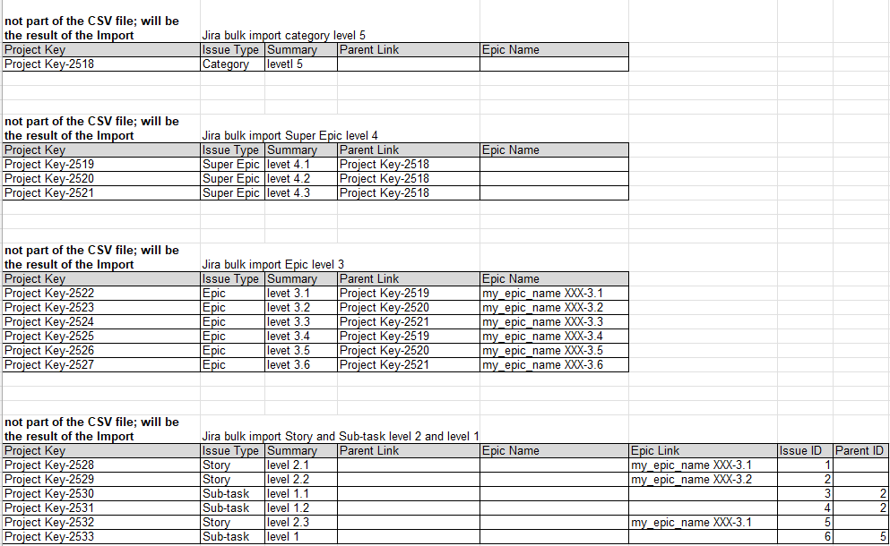

Hello Everyone,
I hope the following can help to those that have this issue. I did my research and create the below template. It seems to be stable. Please, check and hopefully can resolve your issue.
Those are the links to the parents in the different level - the are not the same and what cause the issue. You can use 4 files. That will ensure no mistake, no warning, no error and simple to create.
However, if you create an automation to generate the Project Key in advance, as long you keep this specific order it should work. Important note: in consolidate file, the JIRA Validation step will show errors and even the Import Phase will show Warning / Errors due to the internal memory flow the validation steps of the JIRA is working. But actually, it will import well.
Let me know what do you think? if it worked for you or not.
Regard,
Yossi
