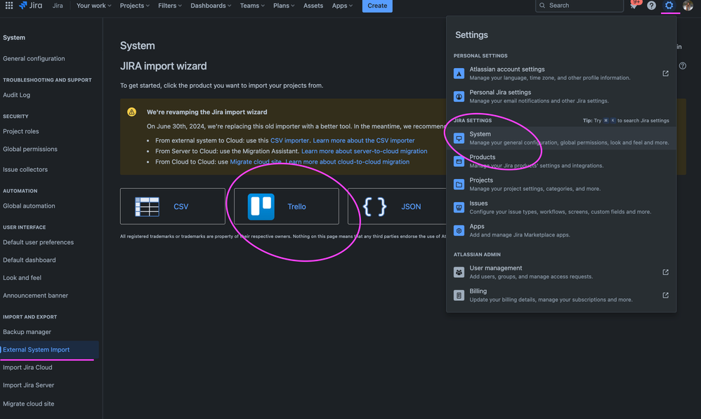

The next question to answer is if you have Jira Administrator permissions. Only a Jira Administrator will be able to access the External System Import function.
Next to your avatar in the upper right corner of the Jira screen do you see a gear-shaped icon?
If you do not, then you do not have the necessary permissions to complete the task. That gear icon is how one accesses the Settings that are available to Jira Administrators.

So Step 1-3 of the document (https://support.atlassian.com/jira-cloud-administration/docs/import-data-from-trello/ ) should be done in your Jira cloud.
You login to Jira Cloud  follow step 1-3Screenshot 2024-03-07 at 9.02.47 AM.png
