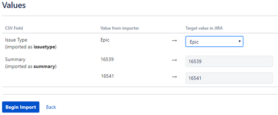

I want to import issues from CSV file. I map issue type as epic but issue always map as tasks.
Here are screenshots:

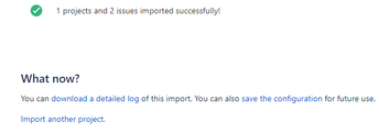

After import there is no warning.

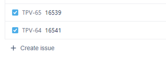

But when I look to my project roadmap there are no new epics, just tasks in a backlog.
Thanks for your help.

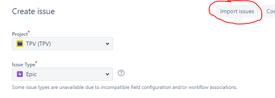

Actually I just noticed that the import works correctly if you do it through creating issue card and not through Jira settings and External system import.
Procedure is the same but there is little difference in the beginning. First choosing file and in the next step choosing encoding. So I suspect that you have two different implementations and one is correct.
