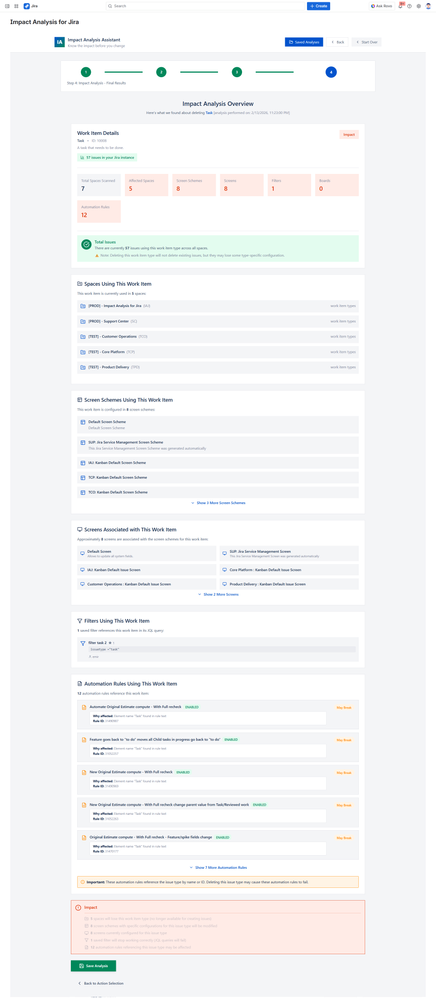

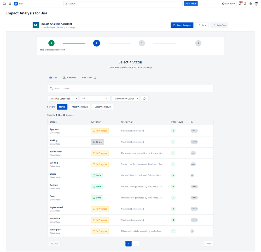

Hello Asier,
My name is Mir and I'm the CPO of Stable Point IO. We are the vendor behind Impact Analysis for Jira.
Our app helps Jira administrators understand the downstream impact of configuration changes before applying them — including workflow/status modifications such as renaming statuses or transitions.
In your specific case, Impact Analysis for Jira can help you identify where the status is currently referenced across your Jira instance, including dependencies such as:
JQL filters and saved searches
Boards and dashboards
Automation rules
Workflow conditions/validators/post-functions
External integrations and linked configurations (where applicable)
This allows you to assess the potential impact before renaming the status and reduce the risk of breaking filters, automations, or reports.
Several of our customers use the app specifically during Jira cleanup and workflow refactoring projects to safely evaluate status/workflow changes before applying them in production.
