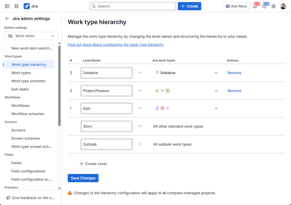

Hi @HQRAZAHS ,
I'd say convenience depends on your reporting, planning, and parent-child relationship needs, but if you want Features to group Stories/Tasks, version #2 is probably more robust.
Also, a good question is why the current config. is 'wrong'? Looking at some Atlassian recommendations, this structure is fine. Even demo Atlassian sites have it configured this way:
Level Level name Jira work types
3 Initiative Initiative
2 Project/Feature
Campaign
Project
Feature
1 Epic
Epic
Risk
Deliverable
0 Story
-1 Subtask
⚠️ Note that you cannot move Epic from level 1; you could rename the default Epic and then use a custom one on levels above/below, but I wouldn't say that's recommended.
As for the impact of changes, what Gor said is pretty much it. It's recommended to review everything and perform some kind of bulk updates before making the 'switch' in hierarchy.
Cheers,
Tobi
