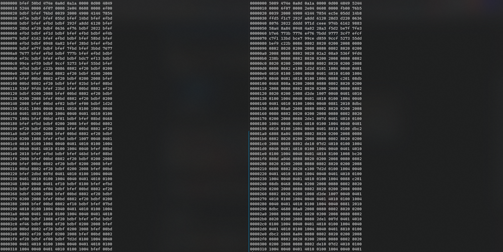

Below is the hexdumps for the correct/uncorrupted image before it is sent to Jira (right) and the corrupted image after being sent to Jira (left)
Note that the corrupted image (left) does not conform to PNG's required header, while the uncorrupted one does. Also notice that there seem to be chunks within the corrupted image that match chunks within the correct image, albeit displaced a few bytes. This could be a coincidence.

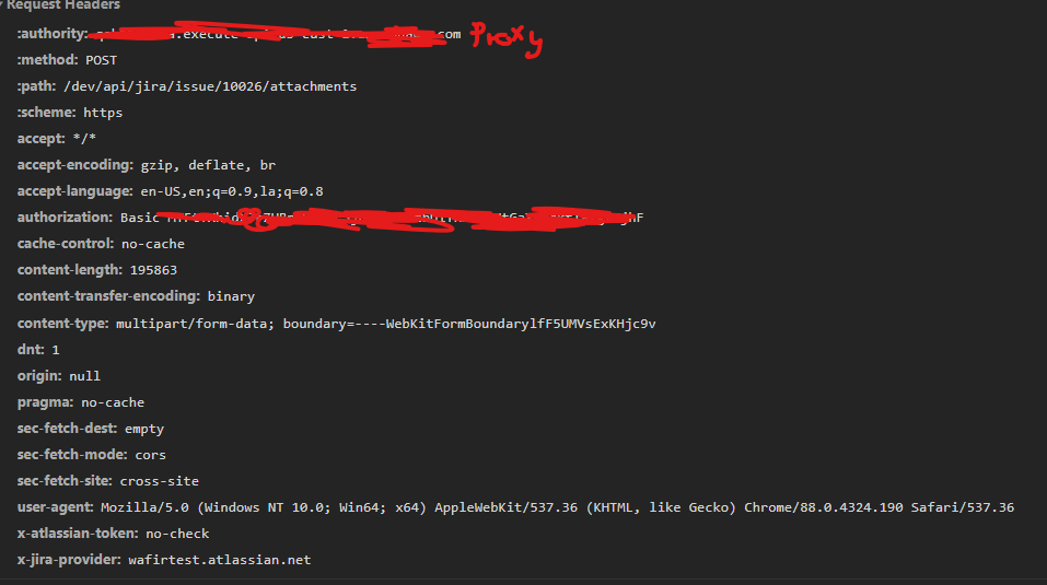

Here are the request headers from Chrome DevTools:

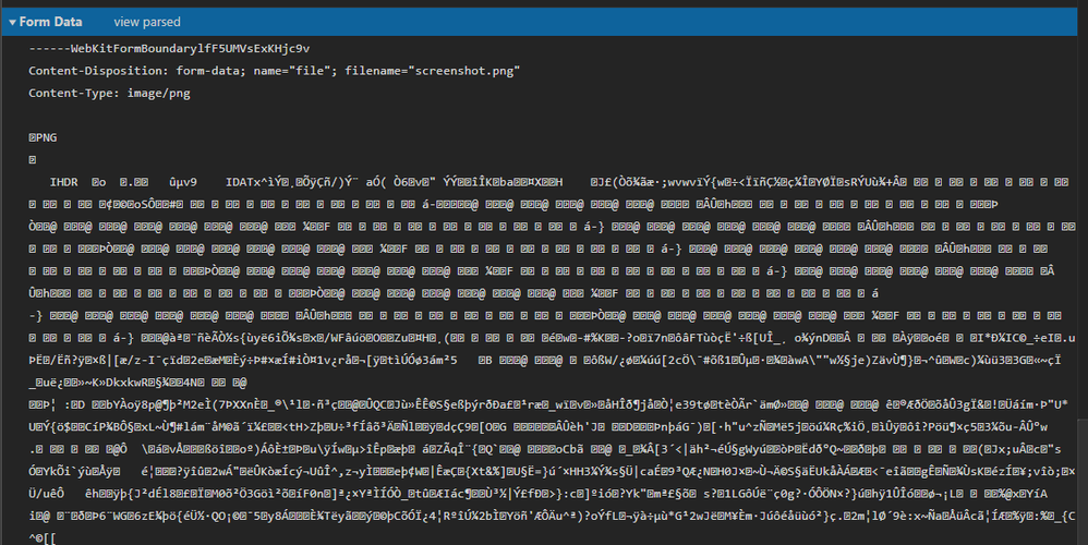

Here is the top part of the request body:
Notice that the header is valid.
