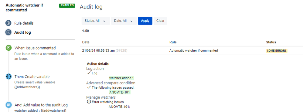

Hi,
My goal is to add as watcher the first person tagged in a comment (no iterative branch in this case). I'm in a data center instance.

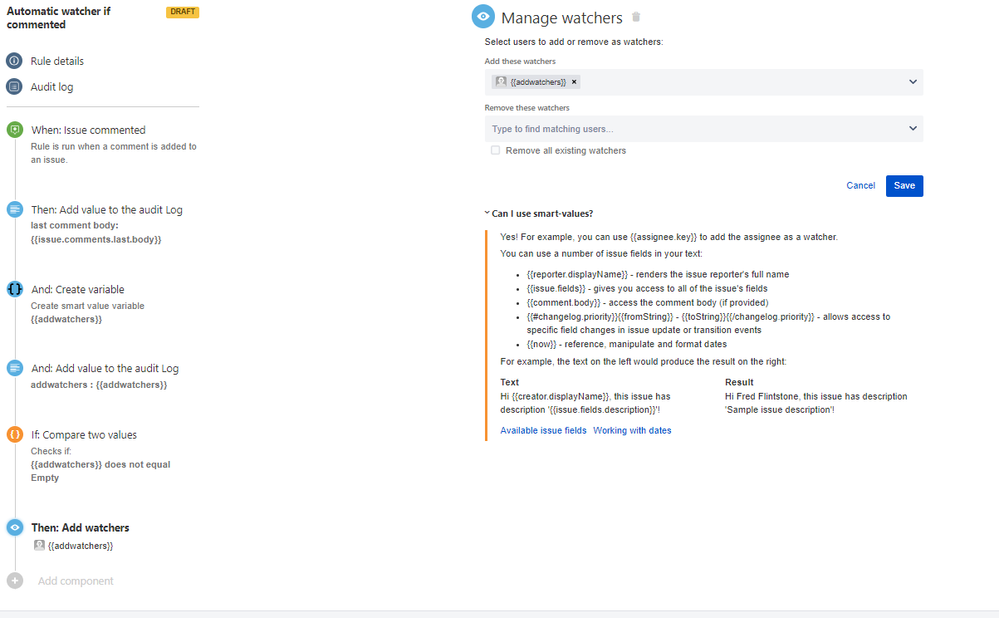

I followed the recommendation from Bill in this topic :
https://community.atlassian.com/t5/Jira-questions/Automation-Help-Add-watcher-when-user-mentioned-in-comments/qaq-p/2121329

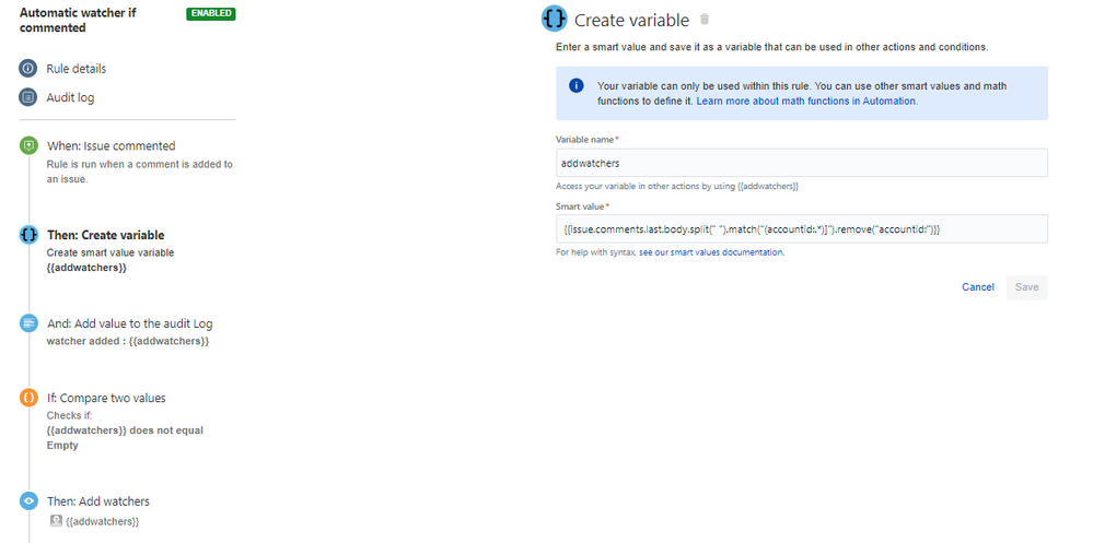

I have done a test by creating a comment with my coworker tagged "Test Automation @mycoworker" and checked in the audit log : the @mycoworker is not recognized.
It looks like the smart value is not working for me:
 {{issue.comments.last.body.split(" ").match("(accountid:.*)]").remove("accountid:")}}
Any help on this please?

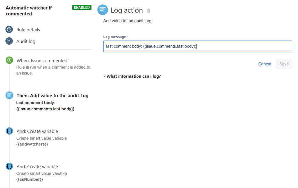

Let's confirm that with your test rule: add a write to the audit log with this:
last comment body: {{issue.comments.last.body}}
Test your rule and review the log.  I suspect the entry looks like this:
last comment body: here is my comment mentioning [~billsheboy] in the sentence
If that is the case, you may adjust the match() and remove() function parameters accordingly.

It displays:
last comment body: Test Watcher [~201034280]
With 201034280 being the identifier of the user.

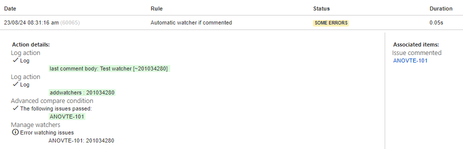

Garn
August 22, 2024
Yes, thanks, we're almost there!
Now I have an error on the manage watchers action:
In my action, I'm adding as watcher my variable {{addwatchers}}
Do you have any clue on the error right here?

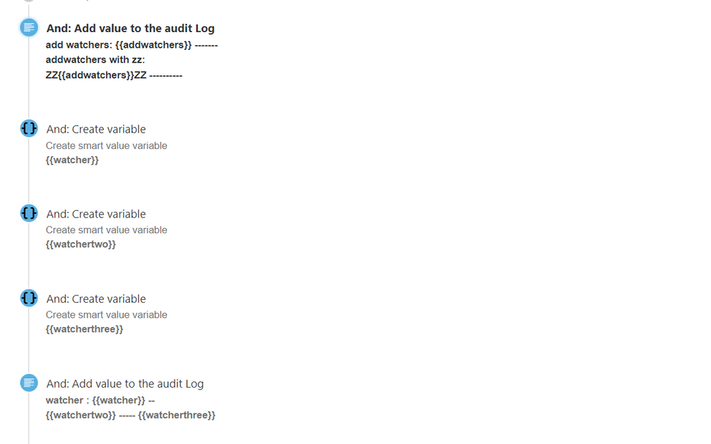

Next, modify your write to the audit log for the variable to this and retest.  This will identify if there are any stray characters leading / following the user identifier.  If there are, they may be removed with the trim() function added to the end.
addwatchers: ZZ{{addwatchers}}ZZ

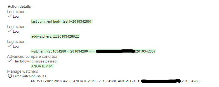

Finally, let's try to set the watch using the user display name.  This will confirm if the watcher cannot be set with the user identifier in a rule action.
To try this, copy the Create Variable action and in the second one, later in the rule, set the value to the exact display name for the user.

Hi Bill,
I confirm that I can manually add the user on the ticket.
I have updated the audit log with : addwatchers: ZZ{{addwatchers}}ZZ
The updated audit log displays :
Log action
Log
addwatchers: ZZ201034280ZZ
I have created two variables:
watcher : ~201034280
watchertwo : 201034280
watcher three : FirstName LastName(201034280)
And the audit log:
watcher : {{watcher}} -- {{watchertwo}} ----- {{watcherthree}}
Please find the results with the same error:

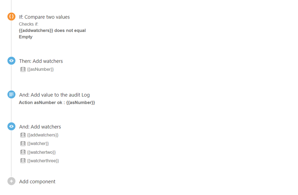

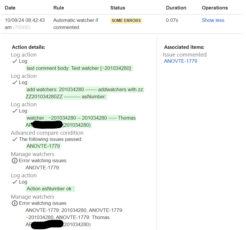

Yes, let me give you here the different codes for variables and the audit log to ease the understanding:
Variables:
addwatchers : {{issue.comments.last.body.split(" ").match("(\[~.*\])").substringBetween("[~","]")}}
asNumber : {{issue.comments.last.body.split(" ").match("(\[~.*\])").substringBetween("[~","]").asNumber}}
audit log2: add watchers: {{addwatchers}} ------- addwatchers with zz: ZZ{{addwatchers}}ZZ ---------- asNumber: {{asNumber}}
watcherthree : Thomas AXXXXXXXXXX(201034280)
audit log3: watcher : {{watcher}} -- {{watchertwo}} ----- {{watcherthree}}
---- and now the audit log:
Looks like my asNumber is not working in the log action 2.

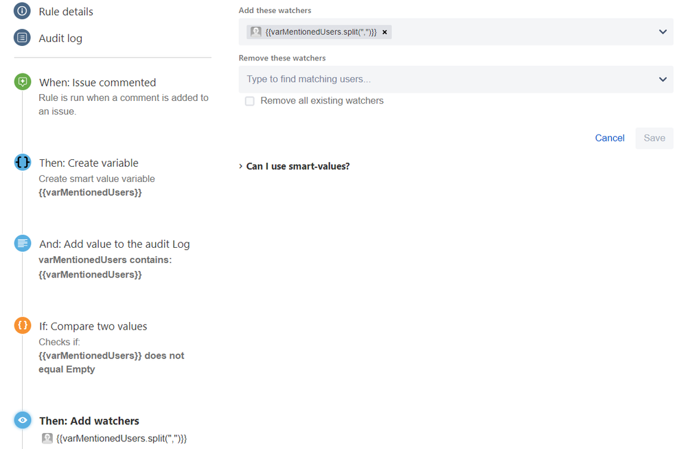

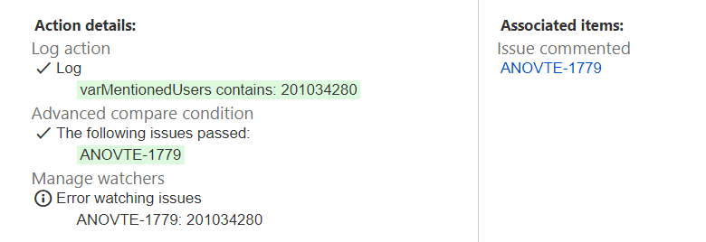

Next, you are trying to add multiple things at one time as watchers and so that could be causing challenges seeing what works, or does not.  Let's simplify to one single test and evaluate what happens:
  • trigger: issue commented
  • action: create variable:
    • name: varMentionedUsers
    • smart value:
{{issue.comments.last.body.split(" ").match("(\[~.*\])").substringBetween("[~","]").join(",")}}
  • action: write the created variable to the audit log
varMentionedUsers contains: {{varMentionedUsers}}
  • action: manage watchers, adding this:
{{varMentionedUsers.split(",")}}
Please note I explicitly added the join() and split() to avoid problems with the list being interpreted incorrectly.
Garn
September 12, 2024
Hi Bill,
Thank you a lot for your help and not giving up this topic 😅
Still the same error.

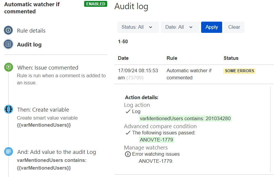

Bill Sheboy
September 12, 2024
In the add watchers, please try using this instead:
{{varMentionedUsers.split(",").asNumber}}
That will confirm if a number is required (rather than text from the variable).
Garn
September 16, 2024
Hi Bill,
Still the same for me even with the change
