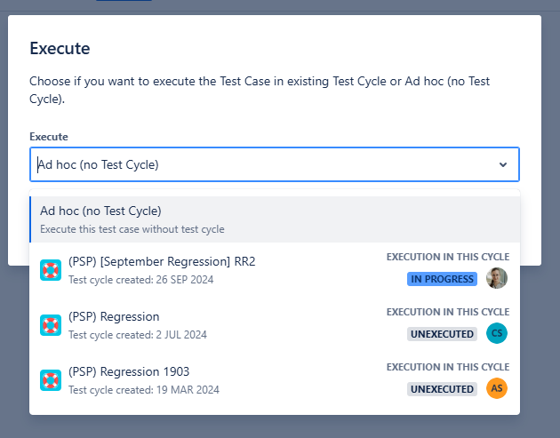

Ican not see the Qality test cycle in the list
Mine
January 20, 2025
As you shown above test cycle could not be shown as a list by listbox. I can see just Adhoc but I can not see project test cycle. Could you please help me about it?Yeni Resim (3).png

Hi @Mine
Thank you for bringing this up. I will be happy to clarify what probably happened.

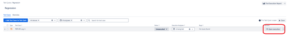

To be able to select the Test Cycle for an execution, the Test Case must be on the list of the Executions added to the Test Cycle.
If the Execution was previously opened or edited, it won't appear on the list. So, if you change Execution Assignee, status, add any comment or click on the play button called Open Execution - it will no longer be selectable from the Jira issue view.
It was designed so to avoid situations where multiple people start the same Execution simultaneously. However, we understand this approach may not be optimal and we have in our plans to improve it. If you have any feedback to us on how you would need it to work, we will be more than happy to hear it. You can reach us on our support page here
Please let me know if you have any follow up questions, I will do my best to assist you.

March 6, 2025
Hi @Mine ,
I’m happy to announce that we have released an improvement to make this process easier and less confusing.
When you go to Manage Apps → Test Case Execution Status, you can customize your statuses. Each status must have a specific status type:
  • Finished, Passed, Failed - which are for executed tests.
  • Unfinished - which are for unexecuted tests.
All previous statuses that haven’t had a status type Passed or Failed are now set as Unfinished.
Previously, when you opened or edited a Test Case Execution, it was removed from the list of available executions when you tried to execute it from the Jira issue view. With this update, all Unfinished (unexecuted) test cases will now remain visible in the list. Even if they are in progress and not yet completed, you can still access them directly from the Jira issue view..
Please test it out! I hope you find this solution helpful and that it eliminates any previous confusion. If you have any feedback or additional requests, we’re all ears and happy to hear them. 😊

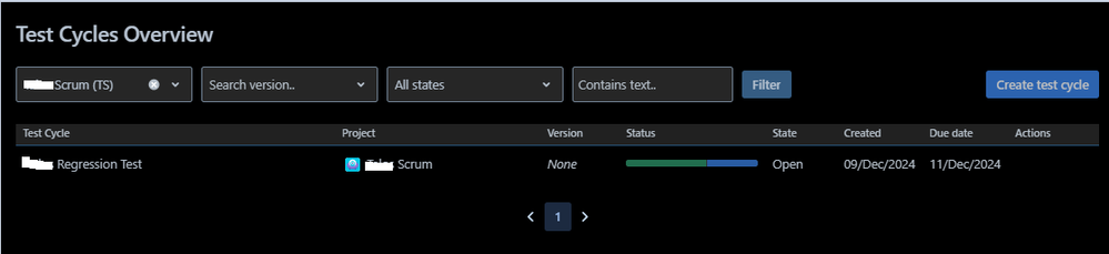

Mine
January 20, 2025
Yes Marc I already created
Marc -Devoteam-
January 20, 2025
This screenshot doesn't provide any detailed information.
Can you show the all created test-cycles in the app and is this test cycle usable in the project where you want to add the cycle?
Like • Valerie Knapp likes this
Mine
January 20, 2025
Here is ss;
Marc -Devoteam-
January 20, 2025
Hi @Mine
That cycle seems to have been added to an issue already.
Ask the developer of the app if its possible to add a single test-cycle to multiple Jira issues, or that you have to create a test-cycle based on a test for each separate Jira issue?
I expect that this is the case, this as an issue might have multiple test cycles, based on different users or systems.
