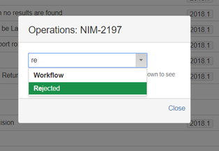

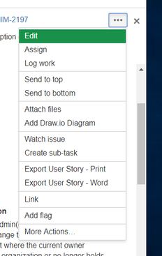

I am going to more actions actions from the ellipsis and then typing in Rejected
and then I get a pop-up where I can add a comment and click on a "rejected" button.

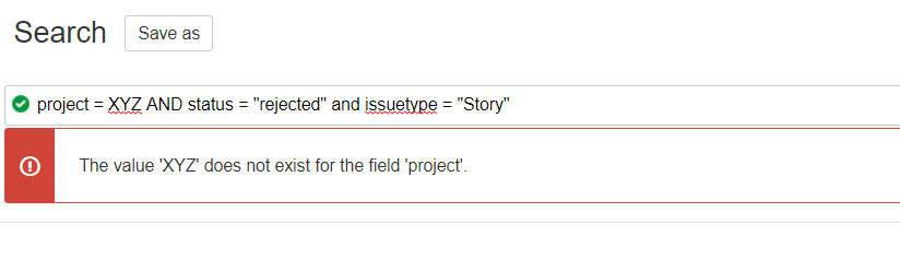

Thank you for helping me. Yes I mean rejected- not deleted. I tried to use that search string and I got an error.

Use the actual project key, not the placeholder xyz.  Try "NIM", as we can see you have a project with that key
Also, do not assume "rejected" goes to rejected, it may be some other status.

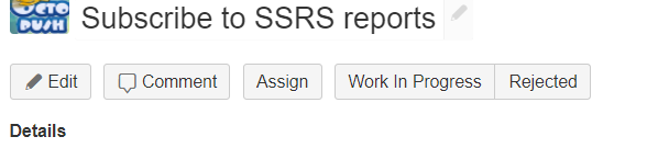

Yes- I removed the <> and it worked! so now I can reject things without having to keep a list somewhere- I just have to remember to add that tag.
I dont think resolution is a required field when making something done- but I havent marked anything done yet. This is how our rejected button looks now.
I am going to talk to our admin about adding a transition from the open status to the rejected status.
Jack Brickey
February 7, 2018
remembering to add a label is where labels breakdown IMO. I would definitely go for the WF approach. The "Rejected" button indicates you already have a transition in the WF for this. Can you provide a snapshot of the workflow? You can see this just to the right of the Status where there is a (View workflow) link. If the Resolution isn't required when "Rejected" is selected then you just need your admin to add that field via the transition screen.

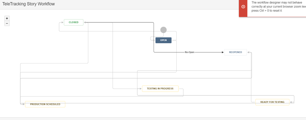

Here is an image of our workflow
Jack Brickey
February 7, 2018
well that is hard to read. :-)
actually what i need is the view from the edit WF view w/ "show transitions" selected. this has to be obtained by the admin. So at this point since you need him/her involved I would recommend you reach out to them and point them to this thread and  my earlier response. they will understand. of course you can stick w/ labels too.
