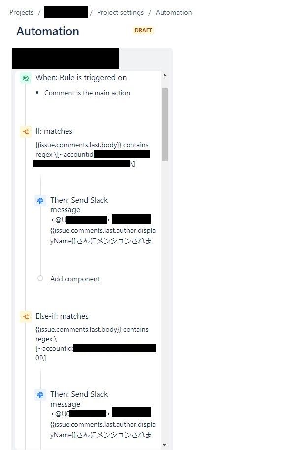

I am trying to make an automation rule that does below:
- Triger: When commented
- If: the comment includes mention
- Then: send a slack message with mention to the specific user mentioned in the jira comment
Currently the rule I made look like the picture below.
This automation works but the problem is the use of if-else condition.
When one of the if-condition is met, the following if-conditions are ignored. Therefore, this rule does not work when I want to mention more than one person.
Are there anyway to fix this? Also, I know the way I made the rule is not very practical, so I am looking for the way to simplify the rule by using variables or look up table.

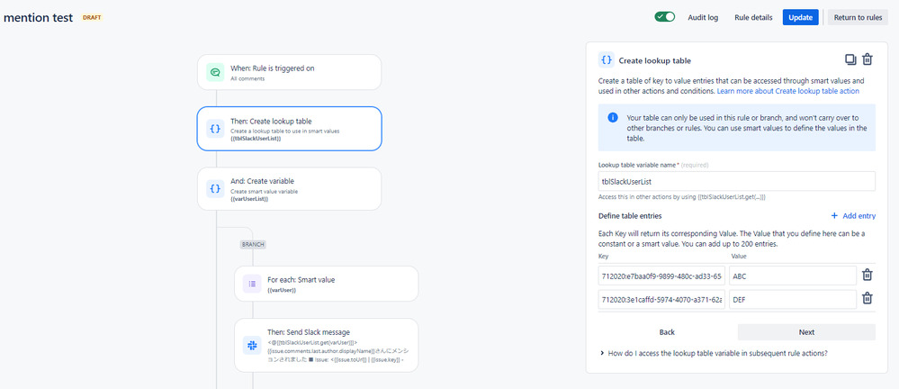

Rather than using an if / else structure, you can simplify your rule to use a Created Table, Created Variable, and Advanced Branch.  For example:
  • action: Create Lookup Table, with a row for each user.  The "key" would be their account id and the "value" would be their Slack id.  Let's assume that is named tblSlackUserList

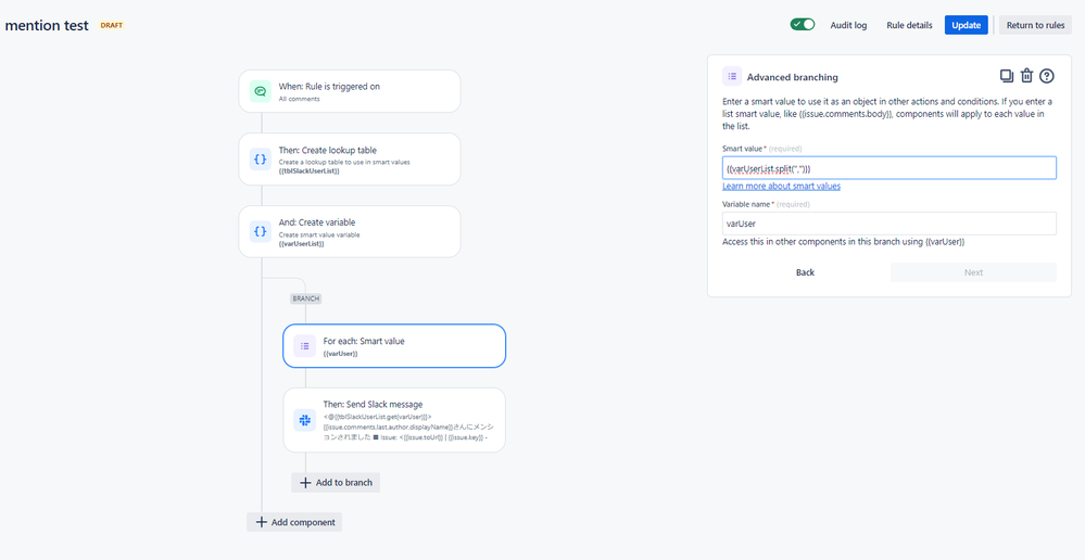

  • advanced branch: to split your created variable into each item for looping with {{varUserList.split(",")}}  Let's assume the variable is varUser

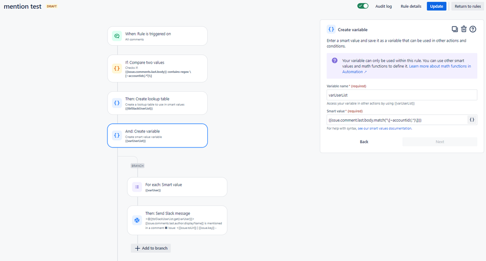

I am not sure what to put on the smart value for varUserList, to make a comma-separated list.
I attached the picture of the current rule. I really appreciate if you can spot when I should change - currently even if the user in the look up table is mentioned, slack message will not be sent.

Thank you. I tried to follow your advice but since I define "varUser" in Advanced branching using "varUserList" so thought it is not possible to put split before the match. Can you explain a little more about what you meant?
Also, I removed "if: compare two values" then, audit log shows an error:
Error rendering smart-values when executing this rule:
Failed to get value for issue.comment.last.body.match("\[~accountid:(.*)\]): {{issue.comment.last.body.match("\[~accountid:(.*)\])}}
it seems the smart value in Create variable is wrong. Do you have any idea how I should fix this?

First, your regular expression in the match() is missing the closing quotation mark, which is causing that error.
Here is the expression I suggested, and I added distinct at the end.  That will handle cases where the same user is mentioned multiple times in the same comment.
{{issue.comment.last.body.split(" ").match("\[~accountid:(.*)\]").distinct}}

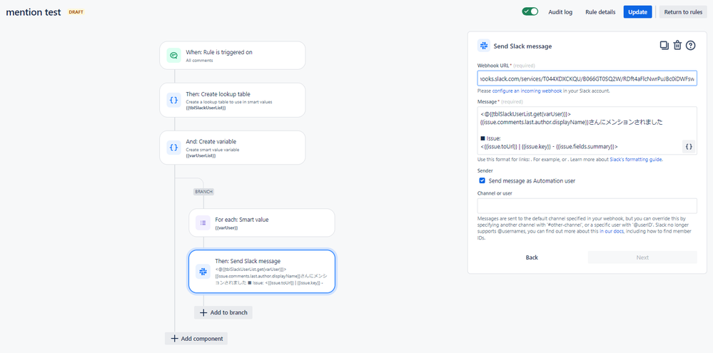

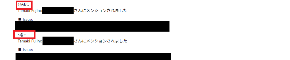

Let's say I have two users (the first picture), and I mentioned them in a comment.
But slack messages look like the second picture. Only the first value is correctly sent.
Any idea where I should fix this? I attached the smart value for branch (the third picture) and the content of slack message (the fourth picture).

Okay, I removed the prior message, as here is the problem:
The result of that expression is a list...but we stick it into a variable.  That then joins the values with commas AND adds spaces to make it more people-friendly for reading.
As a result, each variable (after the first one) in the advanced branch as a leading space.
We wanted that expression without extra spaces as input for processing, and so we can override by explicitly adding our own join:
{{issue.comment.last.body.split(" ").match("\[~accountid:(.*)\]").distinct.join(",")}}
That will make input that can cleanly be handled by the advanced branch's use of split().
