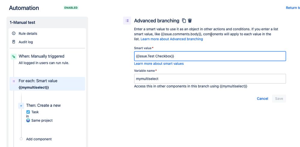

To clarify your scenario, are you trying to create a new issue for each value selected in the multiple-select field?
If so, you could use an Advanced Branch to iterate over the values in the multiple select field, and then create the issues.  Please look here to learn more about that technique:
https://community.atlassian.com/t5/Automation-articles/Branching-over-smart-values-in-Jira-Automation/ba-p/1741935
Kind regards,
Bill
Jack Brickey
September 25, 2023

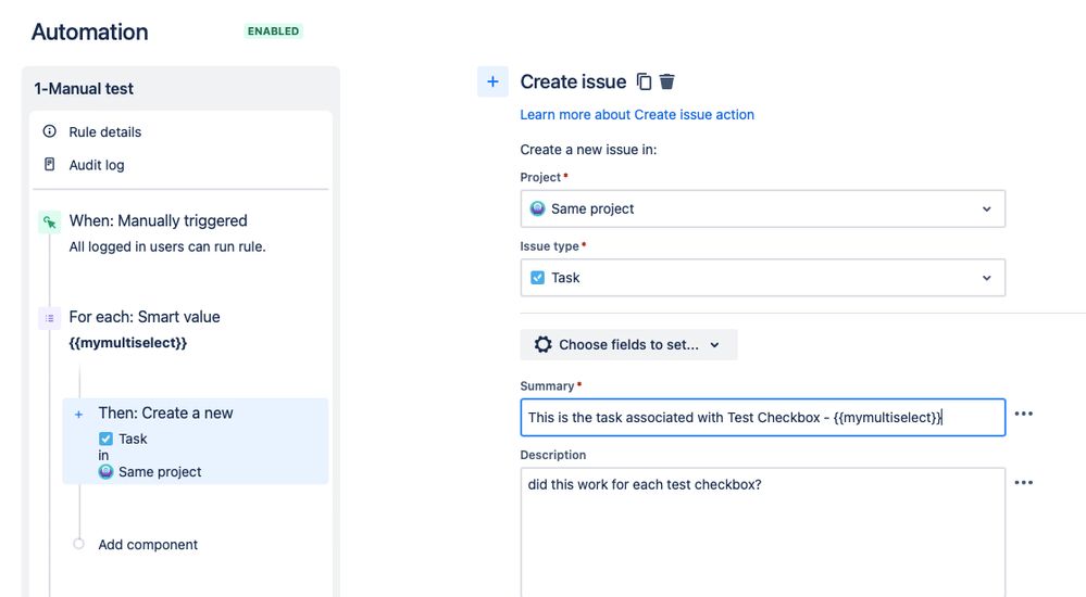

agreed and here is an example below. I tested this with Components field and also a multi-select checkbox field. Tasks were created and the name (value) of each multi-selection was placed in the Summary.
