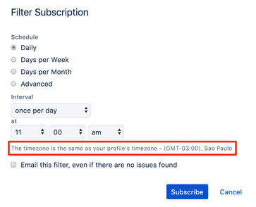

There was a bug related to timezone and filter subscription, it was resolved for Jira Cloud. I tested here changing the system timezone to a different one from the profile timezone and it shows correctly:

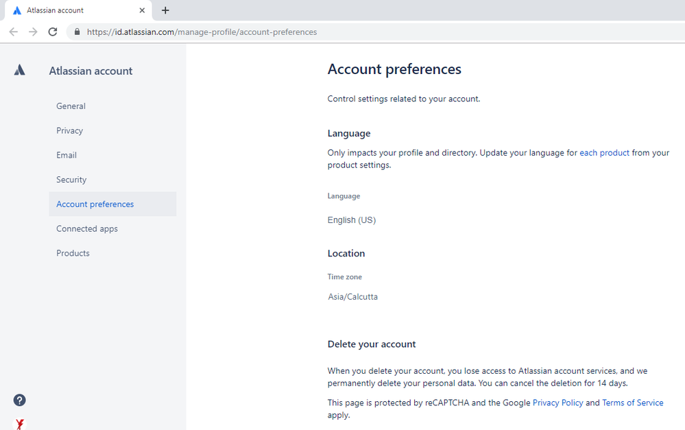

Can you please check if your timezone is correct on your Atlassian account?
- https://id.atlassian.com/manage-profile/account-preferences
It shouldn't affect the filter subscription, but we can try.
Yes it is with correct time zone. And also in the manage profile my time zone is kept correctly but still it is showing different time zone in filter Subscription
