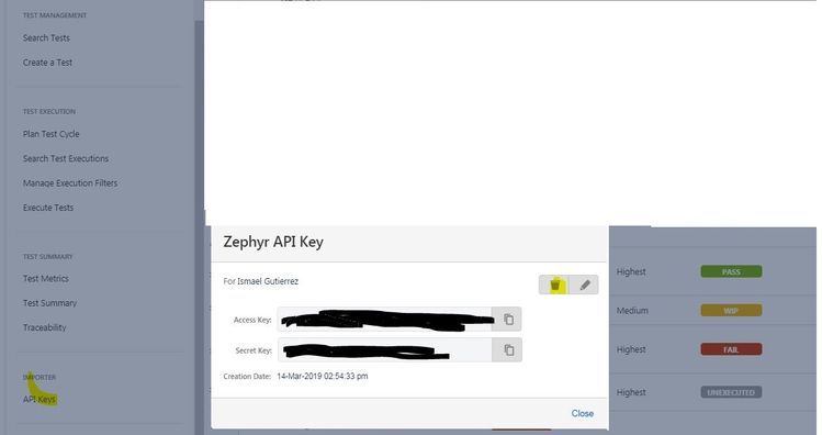

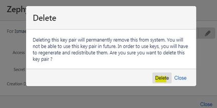

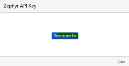

This is what worked for us:
Delete the current keys going to API keys, then Delete the keys:
Confirm Deletion
Then Generate new keys:
And then use those new keys in the importer tool. There was some suggestions online that just Regenerating keys (little pencil next to delete button) should work, but that option did not work for us.
