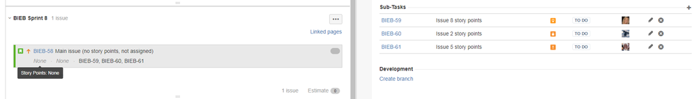

We work with tasks and subtask. Each subtask is assigned to an user. And story points are also saved per subtask. So when I plan a sprint, I would like to see per user how many story points are assigned.
If I use story points on the main issue, on top of the (future) sprint the avatars of all users are shown. But if I use story points on the subtask, no avatars are shown, no totals are shown.
I attached a printscreen to make it (hopefully) clearer:8-2-2018 10-11-52.png
Does somebody have an idea?

storypoints are not aggregated from subtasks to main issues (Stories).
Since you don't have subtasks in a scrum backlog, you don't see the storypoints in the backlog.
You have to assign the storypoints to the main task, not the subtasks.

I do want to assign storypoints to the subtask, because every subtask is assigned to a team member. I have to know if user X has 20 story points assigned and user Y only 1. I have to divide the work. And for example a designer in the team cannot do the work of the programmer right? So I need to know if I can add extra work to the designer in the future sprint. That is also why I want to see the avatars of every user on top of the future sprint to check the estimated stpry points per user.
What is the reason that if I use hours, I can assign the hours to the subtask? And I can display on the card of the main task the sum of the estimated hours of all subtasks? But this is not possible when I use story points?
Is there no other way to make it work?
