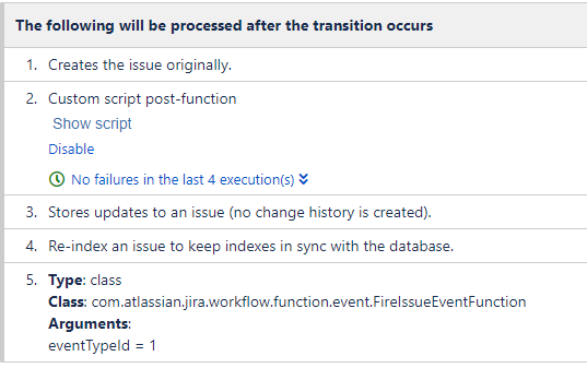

 - It must be after 'Creates the issue originally' and before 'Re-index an issue', similarly to:
Make sure to publish and whenever you create a new issue using this workflow then it should be getting the value stored automatically.
