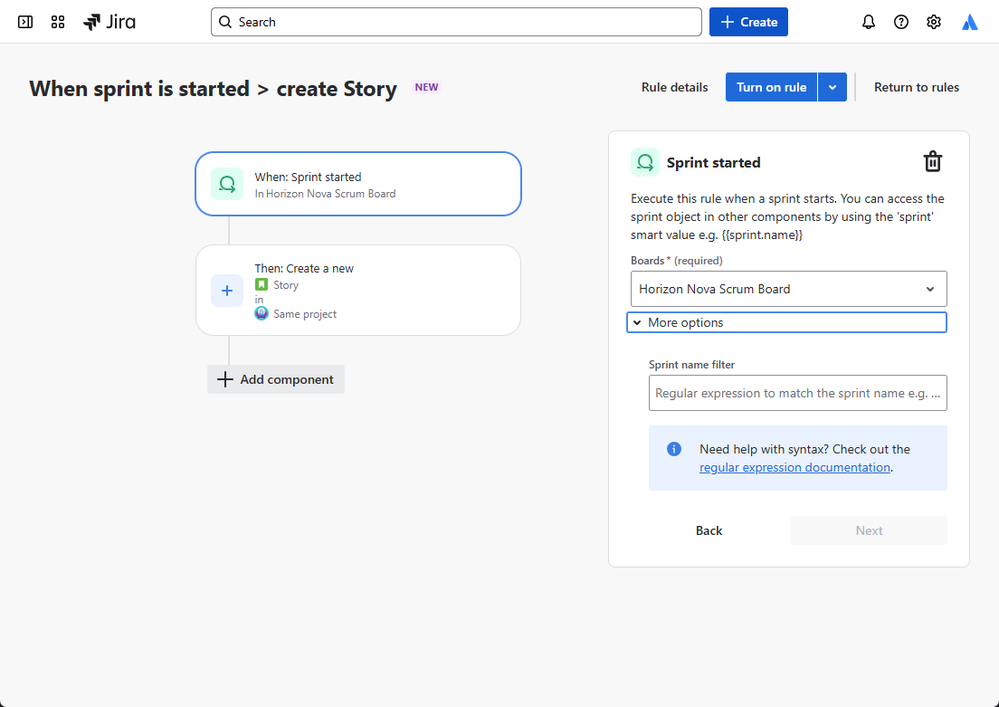

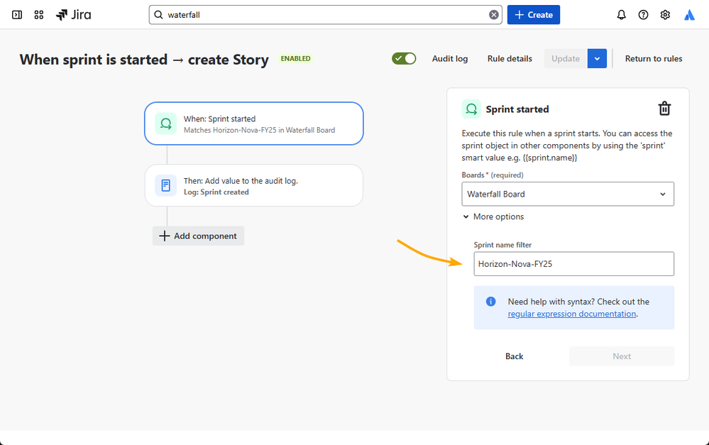

@Tomislav Tobijas . Actually we have same board for each Squad and Sprint name starts with "Tribe name-Team Name-FY25 4.1" for each team
@Vinod Patole nevertheless, you could use Sprint name filter option within the trigger and just add "Tribe name-Team name-FY25" or whatever filter you'd like and it should trigger whenever this specific Squad sprint is started (just tested).

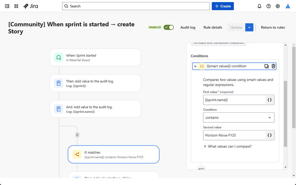

@Vinod Patole you could just use {{sprint}} smart value instead "Sprint name filter" for your scenario (to fit everything into one rule).
For example:
So you'd need to create a couple of IF/ELSEs, one for each squad within the tribe; but everything would still be within the same automation rule.
