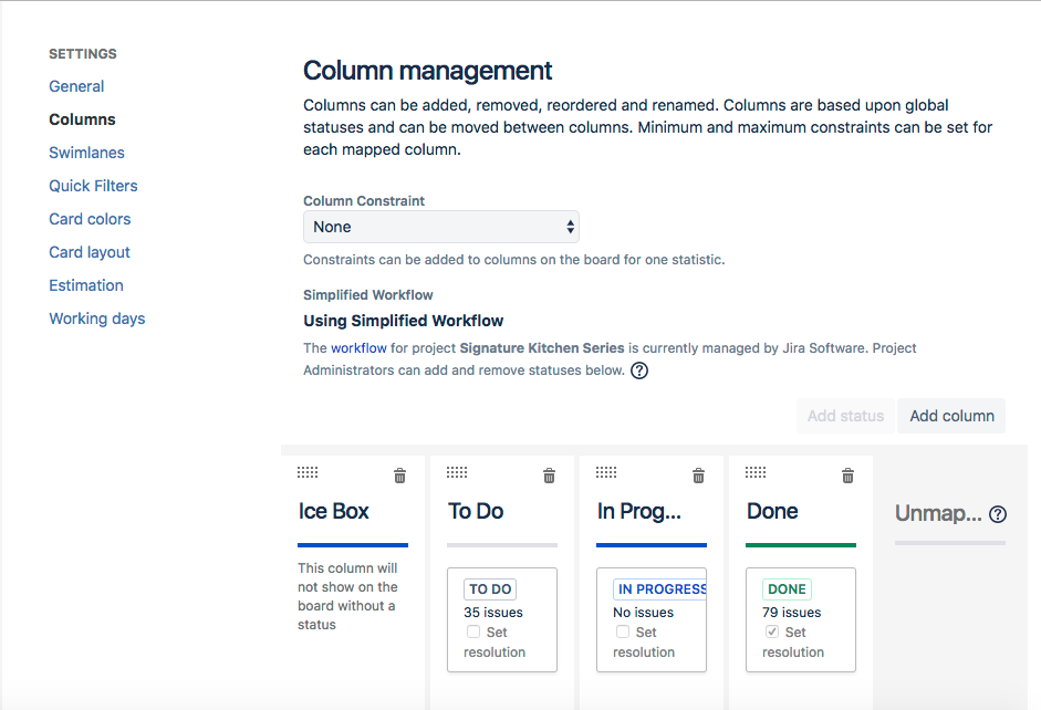

Luke Reed May 2, 2018
I names the status "Ice Box" to correspond to the column. Screenshot attached.
Bryan Trummer - ReleaseTEAM
May 2, 2018
Thanks for the screenshot. The status "Ice Box" is that a current status in the workflow for the projects that show up in this Board?

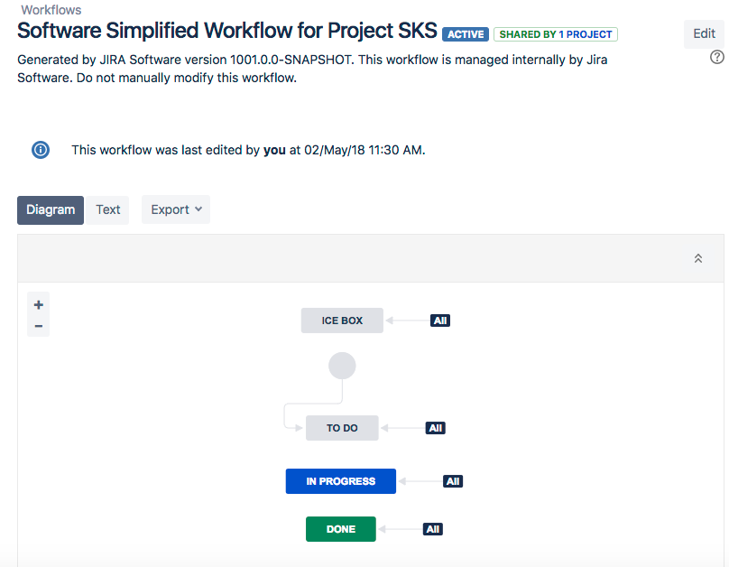

Unfortunately I am unable to assign the status to the column. I've added it to the workflow as described at the link, then published. IU am still unable to assign the status to the column.
May 2, 2018
Does only one projects issues show up in this board (SKS)? Or do other projects issues show up in the board as well?
No, I cannot see the new status. I am trying to create an Ice Box column. When I am in Column Management, I see my new column: Ice Box.
Ice Box has a message that says "This column will not show on the board without a status"
There is an "Unmapped" column, but that column is empty.
