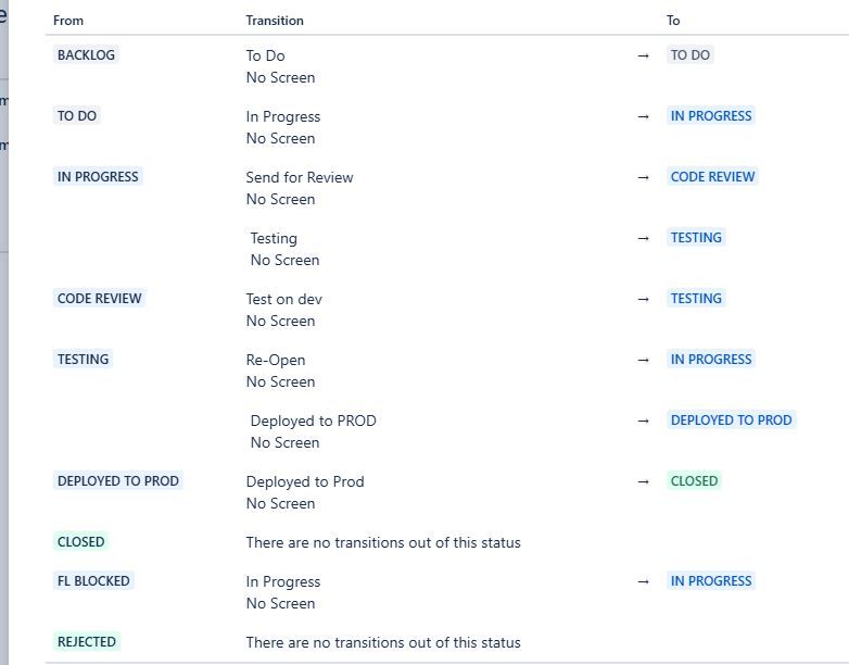

Thanks @Damian Rosochacki can you please be more precise - where do I find the admin section, in the project section? or where else? this is workflow in the project setting

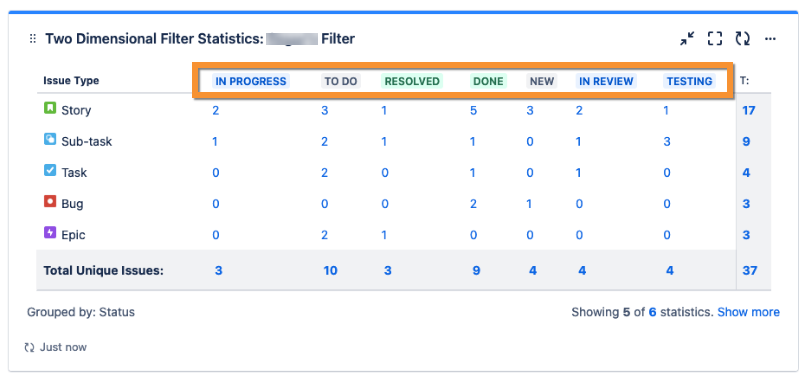

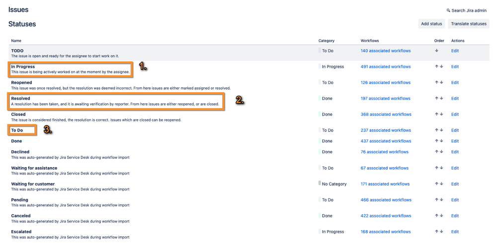

The sorting order of these status in two-dimensional gadget is set based on the global sorting order of the status, as in my below example it "IN PROGRESS", "RESOLVED", "TO DO"and so on, when I move the "TO DO" status above "RESOLVED" then the order is also changed on the gadget.
Please check the below attached screenshot for more details.
If you have a Jira administrator permission on your site you can change this order as per your requirement, but keep in mind that this is a global change and will reflect in all the places where statuses are used.
Before updating the status order

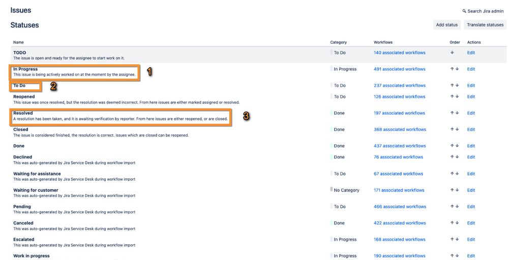

After moving "TO DO" status above the "RESOLVED" status

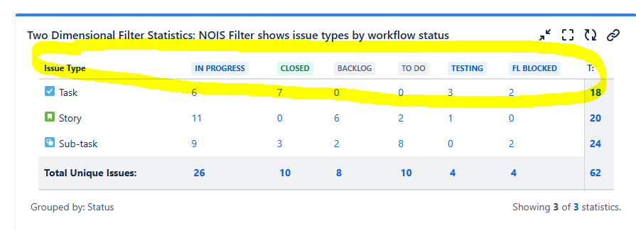

Thank you @Nicolas Grossi However I am struggling to locate where I can edit the view of the workflow in my dashboard gadget - see below I created the above using the 2 dimensional filter and set x axis to issue type. The displayed issue type is illogical in that, from left to right should mirror my kanban columns ie Backlog, to do, in progress, FL blocked, testing, closed. Does that make sense to you? Right now, this gadget is very hard to read and not presentable. I need the urgent help of the community. I am company managed project. thoughts?
