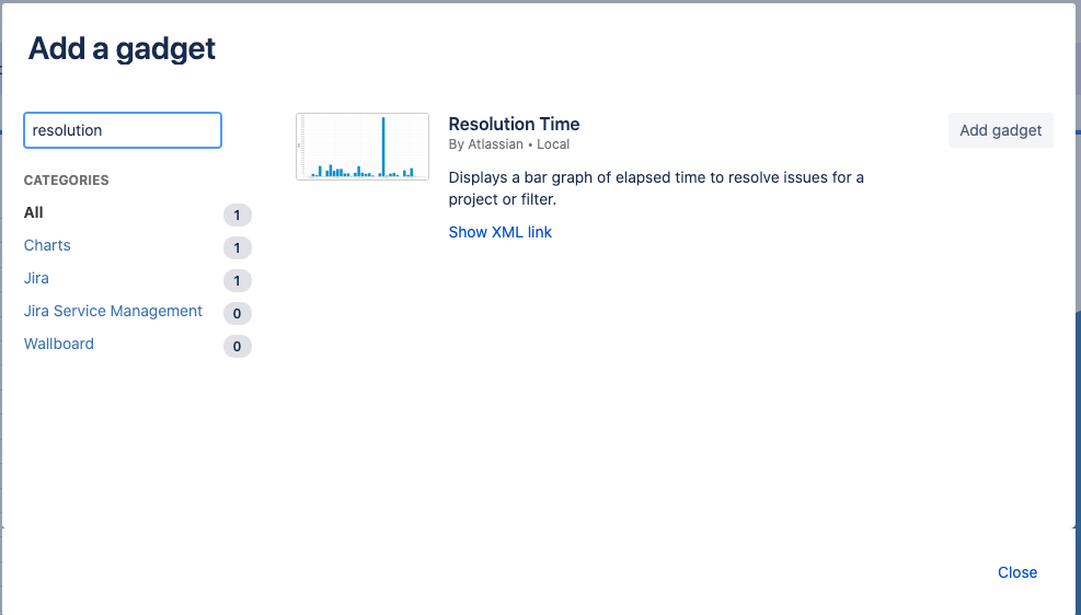

Trudy Claspill
May 19, 2021
There is also a native Resolution Time gadget for the JIRA Dashboard, which works for Software projects, but you are limited on customizing the time period reported on, and I don't know if you can customize which statuses it considers as the starting and ending of the calculation.
Like Diana Cabrejo likes this
Diana Cabrejo
May 19, 2021
Thanks sir, that option works for me.
