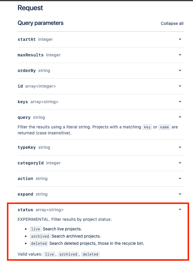

Thank you! To keep the api calls symmetrical is there a "status=..." for active projects? "status=active" did not work.

@Trudy P Claspill Yep, seeing that and thank you for pointing that out! Just to make sure I'm not missing anything, are there any other statuses besides "active" that can be passed to the URL?
Trudy P Claspill
December 10, 2024
ben.wilen
December 10, 2024
Ah, missed that thanks for your help!
