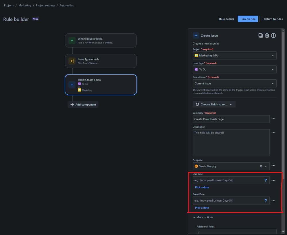

Here is the build I'm working on. The two dates inside the red box are what I'm trying to manipulate. I want to be able to set the event date when I create the parent task. The child tasks are the automation and I'd like to be able to set certain task to have due dates based on when that date is set to. For example, this rule shown would be one week before the event date. By the time it's getting put in here, the date is set and does not change. It's a webinar, so there's no reason to change it. I hope this addresses your questions... Screenshot 2024-02-20 161202.png
Trudy P Claspill
February 20, 2024
So your rule is triggered when a "ChiroTouch Webinars" type of issue is created.
Then your rule tries to create a new issue of type "To Do" in the project "Marketing". And you want to set the Event Date and Due Date in that new issue.
Question 1: In what project does the ChiroTouch Webinars issue get created?
Question 2: You said the Due Date should be a week before the Event Date. But what should the Event Date in the "To Do" issue be getting set to?
I also see that you are trying to make the ChiroTouch Webinars issue the parent of the "To Do" type issue. Can you explain your issue hierarchy?

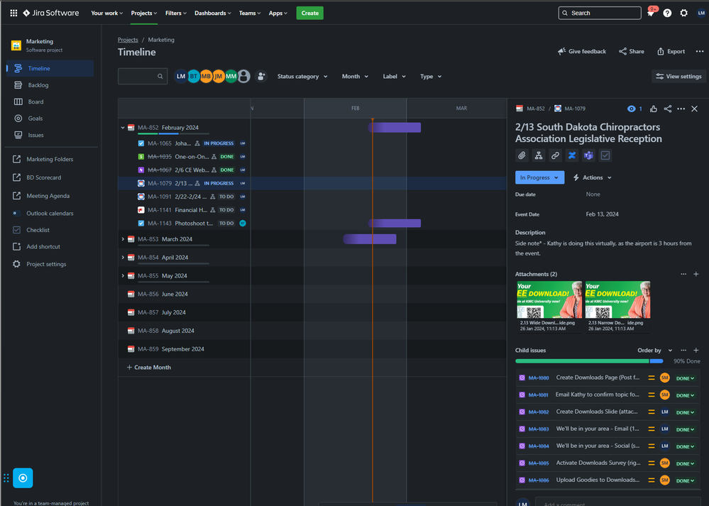

Basically, this is our Marketing Board. It's broken down by months. From there, each event or marketing campaign is its own issue. From there, each issue has its individual tasks that need to be completed for that campaign. I'm attaching the screenshot of how I use Jira. This one is specifically for a recurring event we call a ChiroTouch Webinar. We have 4 activities, the one in the first screenshot is the first activity. The event date is set on the ChiroTouch startup and there is a rule for that to carry through to any child issue. That was an automation I had set up a long time ago, so I just assume it can run that rule then, the due date rule.Screenshot 2024-02-20 163846.png

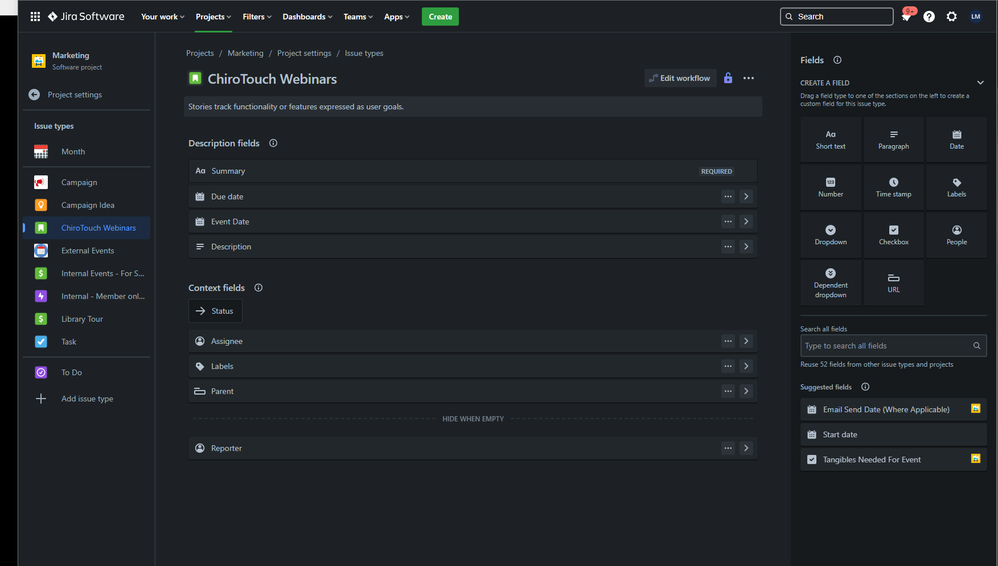

I can see from your image that you are using a Team Managed Software project. And I believe your Chiro issue is a "standard" level issue and the one you are trying to create is a "subtask" level issue.
To confirm that can you provide a screen image of what you see when you go to Project Settings > Issue Types? Specifically I'm looking for the information on your issue types and hierarchy, like this.

Lisa Mills
February 21, 2024
Good Morning! My apologies for not getting back to you yesterday. Here is that hierarchy. I hope this is helpful for you... I appreciate your help so much! It's saving me so much time in the long run! Screenshot 2024-02-21 085137.png
Like • Kalyan Sattaluri likes this
Trudy P Claspill
February 21, 2024
Great! That confirms the Chiro issue type is a "standard" level issue and the "To Do" issue type is a subtask.

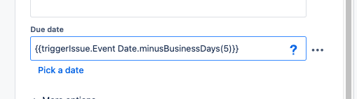

Date minus unit {{[date].minus[Unit]([number])}}
You need to decide how much you earlier the Due Date needs to be, determining the unit (i.e. calendar days, business days, weeks) and the quantity. Let's say you want the Due Date to be 5 business days earlier than the Event Date. The smart value you would use is
{{triggerIssue.Event date.minusBusinessDays(5)}}
You would type that into the entry field for the Due date in your Create Issue action.
Smart values can be case and space sensitive. The "I" for "Issue" in "triggerIssue" must be capitalized. The field name "Event Date" must match the capitalization and blank spaces of the actual field name.

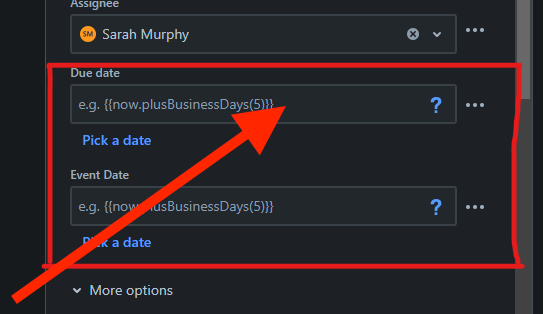

I'd be happy to explain. We do a webinar with a business partner monthly. There are tasks that need to be completed for each occurrence of this webinar. I'm trying to set up an automation, so that when I say it's this type of event, it populates those tasks and due dates based on the event date I set upon creation. I'm attaching the screen grab here. The red box are the dates I'm referring to. Thank you for your help! Screenshot 2024-02-20 161202.png
