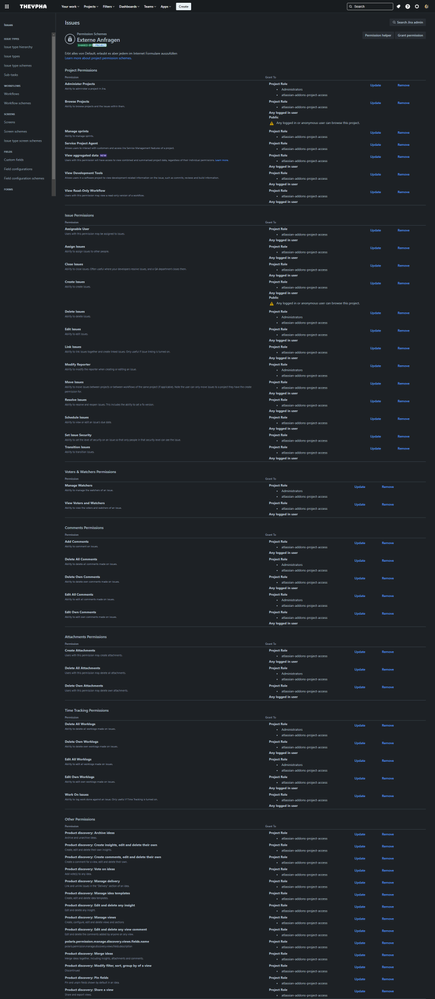

Can you show the Permission Scheme for the project?
To which permissions specifically have you granted access to Public?
Like Loapu likes this
Loapu
June 6, 2023
I hope this answers the question.
Trudy Claspill
June 6, 2023
Based on the documentation, that should work. I have not found any posts or other articles that indicate it would not work. I don't have a paid subscription instance where I can execute tests for this.
