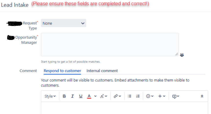

Hi @Crystelle S  - when required fields are update, still Transition Screen popup whenever we more to that transition ...
Or is there any we can populate any message next to transition name like given in below image....?

Messages as far as I know cannot be added to the header. I am a little curious to know why you want to put a message here, if the process is modified as I describe above or Jack Brickey describes below? Wouldn't the popup only show when the fields are blank and won't the required asterisk be the cue to the user?
