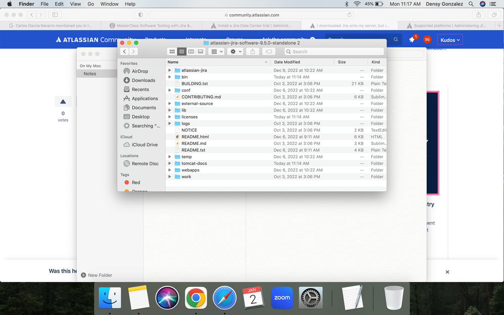

I am using OS Mojave. Once I download the Jira file, it does not automatically open. It just shows me all the files and folders. Do I need to download something else?Screen Shot 2023-01-02 at 11.17.50 AM.png

It works fine on a Mac, although it is not supported as @Carlos Garcia Navarro says, and sometimes it will fail quickly and hard if the environment has been a bit mucked around.
The problem here is that you're not actually running anything.  The installation creates a whole pile of files that make up a Jira, you don't just open it up and have it run.  It looks to me like you have either opened up the installation directory in a file manager, or simply opened the archive file and looked at it - archive files are just containers, there's no "run" for them.
If it is an archive file, then find it in your file manager and try a right-click - you should be offered the option to expand all the files out of the archive into a directory.
If you were looking at an installation directory, or you created one from an archive file, then the best thing to do next is fire up a command line, cd into the install, then go down into the "bin" directory (shown in your screenshot).  You should then be able to run "start-jira.sh" which will try to start Jira.
