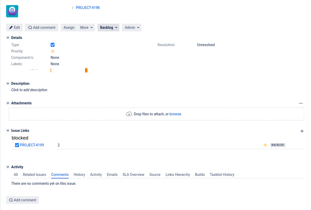

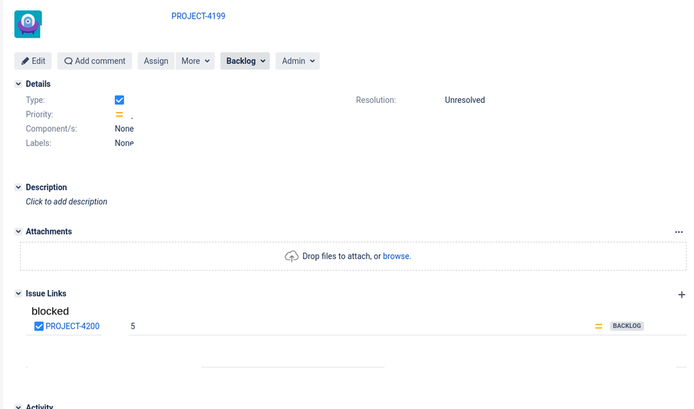

Please help me figure it out, I've been struggling with this problem for a week now.
I'm trying to come up with an algorithm so that I can add values ​​from a trigger task to the entire chain of related tasks.
My germ of code that I ended up with (I'm using the script console - scriptrunner):
import  com.atlassian.jira.issue.link.IssueLink ;
import com.atlassian.jira.comComponent.ComponentAccessor ;
List issuesFromEpic = []
def Issue = Issues .getByKey( 'PROJECT-4198' ) //issue trigger
IssueEpicLinkName = ComponentAccessor .getIssueLinkManager().getOutwardLinks(issue.getId())findAll {
it.issueLinkType.outward == "blocked"
}*.destinationObject
IssueFromEpic += Issue
IssuesFromEpic += "blocked ->" + IssueEpicLinkName
return IssueFromEpic
//output: [PROJECT-4199]
 (PROJECT - 4198 blocked-> [PROJECT-4199])
//Next expected result:
//get [PROJECT-4199]]
//[PROJECT - 4199,  blocked ->[PROJECT-4200]]
//get [PROJECT-4200]]
//[PROJECT-4200, blocked ->[PROJECT-4201]]
Total :
List = [PROJECT - 4199, PROJECT-4200,PROJECT-4201]
Thanks for any help.
Best regards, Alex.

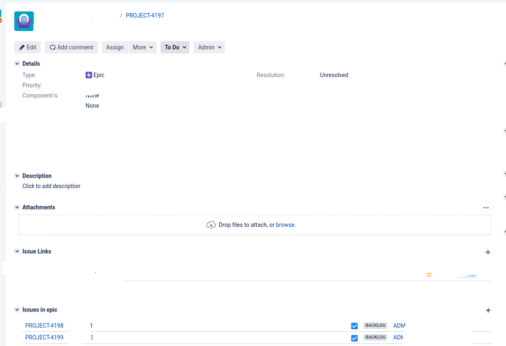

@Nic Brough -Adaptavist- HI!
Input: I have Epic, which has Issues in epic. TRIGGER: When a field is updated in one of the epic tasks, then the script is required to update this field for all epic tasks, with the link type "blocked" , linked with the issue trigger
