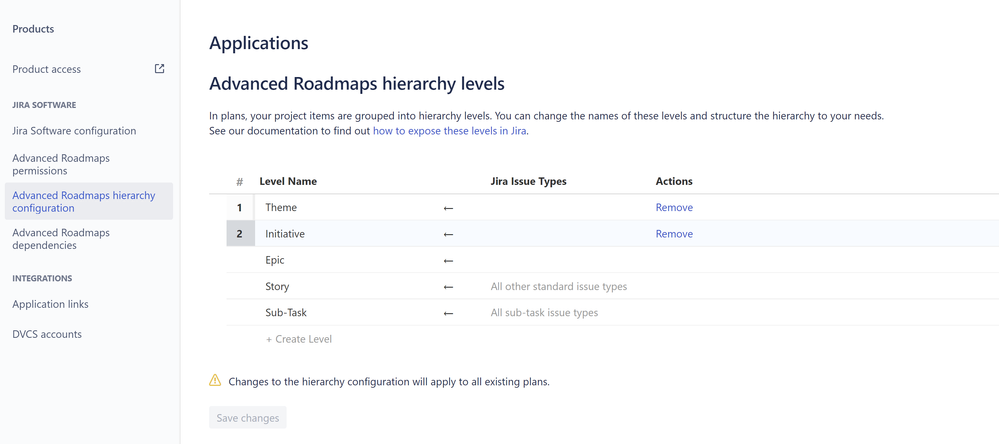

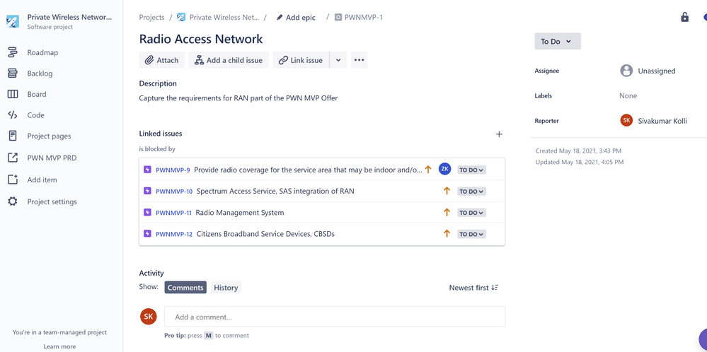

I am trying to add a bunch of Epics to an "Initiative" and bunch of initiatives to a "Theme". I think I created the issue types 'Initiative' and 'Theme' but can't seem to be able to get the hierarchy right. See the screens for what I am seeing in my Advanced Roadmaps and in Project backlogScreenshot 2021-05-27 161003 JIRA Screen 2.pngScreenshot 2021-05-27 160842 JIRA screen.png
Trudy Claspill
May 27, 2021
The hierarchy looks correct to me.

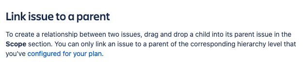

I don't actually use Advanced Roadmaps, but from this document it seems that you make an issue a child of another issue by dragging and dropping it on the roadmap itself.
