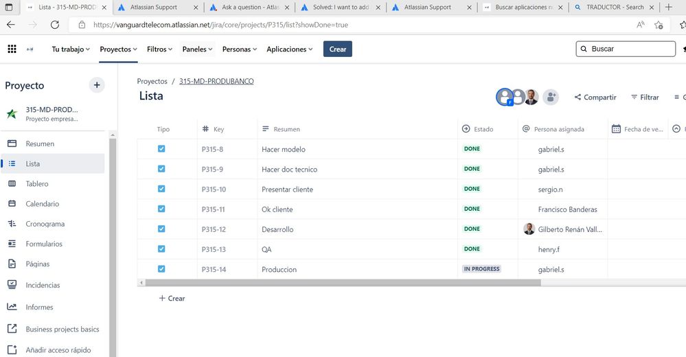

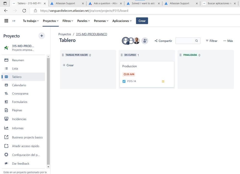

Hi, i have some problems with the tool. I dont see all the activities of my projects in the kanban dashbord, these is happeneing for all the activities independent they are in the step to do, doing or done.

Hi Francisco - Welcome to that Atlassian Community!
After the issue has been done for 2 weeks, it automatically drops off of the board. This is built-in functionality that cannot be changed currently.
